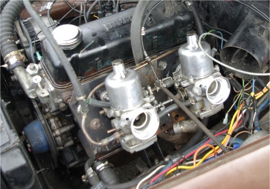

Basically I've got a pair of HIF4 carbs now attached to the Datsun 1500 motor in my Midget.
The reason I'm posting here is that I figure more MGB owners are used to having to deal with the HIF4 than Midget owners.
Any help at all will be greatly appreciated.
Basically I've bolted a pair of HIF4 carbs to a dual intake manifold connected to a high performance GX cylinder head.
The carbs don't want to run right, symptoms include running very rich to the point of smoking up the neighborhood, not running at all, running but wanting to race away up to 4k - 5k rpm, sometimes idling properly, most of the time not. I had a higher pressure fuel pump, we swapped it out to one that does only about 2 psi.
I will be going out to work on it again today, it would be great to get this problem solved - again any help at all would be great!
RickB
RickB
I just went out and turned the key on, gas started coming out the front carb overflow.
Pics:
RickB
RickB
and another

Notice there is a fuel feed hose that loops around to the back carb?
I'm looking and looking and looking and not seeing it until just now, the things have a hose that goes between the two carbs at the front, supposedly to feed fuel from the front to the back carb.
So why does this fuel line from the pump go to both carbs I was wondering?
I look and look at the diagram in the book and it just hits me - there's a fuel feed hose to the front carb but the back only has "breather pipe" and "vent hose" connections on the right side - no fuel feed in over there as the fuel feed in is on the left side of that carb!!
So - what happens when you feed fuel into the carb via the 'vent tube' or the 'breather pipe'?
Whatever it is, I will bet it isn't good!!!
Going out to make it look like the book right now. Will report soon.
RickB
RickB
So as you might imagine hooking up the fuel so it only goes where it should and doesn't backfeed into the VENT made everything way way better.
