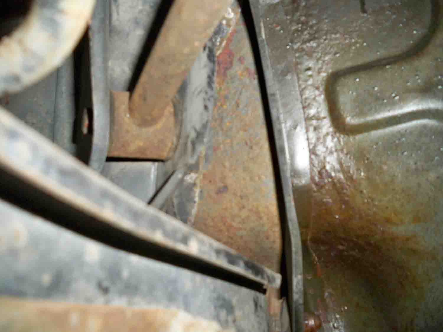

Second is the body panel where the left trailing arm attaches. See pic below. As you can see there is some bubbling under the factory sealer in the seam which made me look at the rearmost part of the rocker panel where the molding is. There was some bubbling there too I think I could have pushed the screwdriver through the rocker. I didn't have time to remove the carpet behind the drive seat. He was very willing to do it but it looks like a big job and i had to get. The other side was perfect.

Is this pic a big concern? The rust looks like it is comming from the inside if the panel. This I think is the area where everone was warning me about.

Looks like surface rust bubbling under a coating of waxoil. Wire brush, treat, paint, undercoat and it's fixed. If left alone and kept outside, it will blossom into full fledge rot. The problem area isn't on the vertical panels, it's on the lower panels facing the ground just in front of where the lower control arm bolts to the body. That's the lowest point for water to settle inside the car and also the part that sees the most stress under acceleration. The seem that sees the most issues isn't treated from the factory. It's bare or barely primered metal with a permeable seem sealer over it. The seam sealer acts like a sponge and holds the water near the metal.
