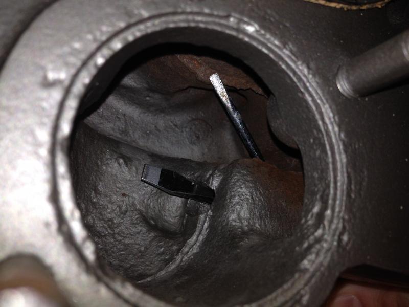

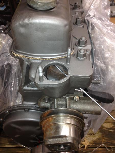

I just got my engine back from the machine shop all assembled and found a rust hole in the head! I've talked to the machinist and he'll take it apart without charging me and weld it. My question is whether there are other areas to check for rust as well?
It would be bad to miss something now and end up with oil in my coolant or coolant in my oil. (Two things that don't go great together- Actually that could be another thread as I've heard of oil being put into the cooling system...anyway I digress) In talking to the machinist, he said he could pressure check the cooling system with air. Any other ideas?
I did find SC Parts sells a an Oil Gallery Repair Kit with part numbers 306279 and 344716 selling for 250lbs and 112lbs respectively. Does anyone have any experience with these?
How does your machinist propose to weld up a rust hole in cast iron without preheating the entire piece and not distorting it and being able to put it back together without further machining valve set cutting skimming etc . This guy must be a miracle worker ??
Find a good used head and replace the one you have. That is the best suggestion I came up with.

Welding the head shouldn't be a big deal, I had a 38 Olds block welded with nickel rod a number of years ago by a old, experienced welder. It worked okay, but the problem is that it didn't seal 100%, and weeped a little. He said to use radiator stop leak and all would be fine, which it was. But this is an old school fix. Perhaps a better one is to drill out the hole and install a threaded plug, if the location of the leak will facilitate that?

Reading this post really has me confused. Being a mechanic for the last 45 years , I thought I saw it all. In all the years, I have never seen a cast iron cylinder head or block rusted thru as stated . I've seen broken crank , cam and rod damage and thousands of cracked blocks due to freezing and overheats, but never seen a rusted thru casting. If you have a picture of this, I would love to see it . I also would get a different mechanic and would not let anyone use a welder on that cylinder head or block. Sorry if I sound aggressive, but this post really hit a nerve .

I agree and doubt his problem really was rust. Usually the issue is leakage caused by cracks/corrosion at the spots where there is little metal between the oil and water passages.

I had a head at my machinist that turned out to have a hole in one of the intake runners. Probably due to sloppy casting at the factory years ago. I had another head, but a DW AL head is a viable option.

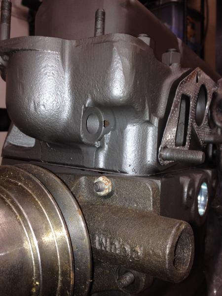

Oops, I forgot to include the pictures. To fix it, the shop used a tapered threaded plug. The plug is slightly softer metal. They ground it off and then peened it. They then pressure tested the cooling system with air. They did not find anything leaking in the block, thankfully.
I guess I’m not surprised there was a rust hole. The radiator hose was off the car for many years, so there were plenty of chances to get water (and air) into the head. I purposely bought my car all rusted out as I had it all along I was getting a new Kilmartin frame. I also have an extremely talented, patient club member who has put the car back together when it should have been crushed a long time ago. He has truly resurrected the car and built something better than brand new.
