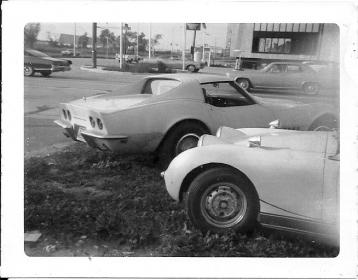

Great story Rick! Reminds me of the time back in the late 60's when a friend and I were cruising around some winding roads in Bloomfield Hills, me driving my Bugeye, and he driving his new '68 L88 Corvette Stingray. Both cars were Safari Yellow at the time. Were were stopped by a local cop and accused of 'drag racing'. My friend, ever the Corvette fanatic, busted out laughing so hard, he actually fell down holding his gut with laughter. I thought we'd be done for, but the cop was actually so embarrassed (I assume), that he just gave us our licenses back and drove off... :congratulatory:
