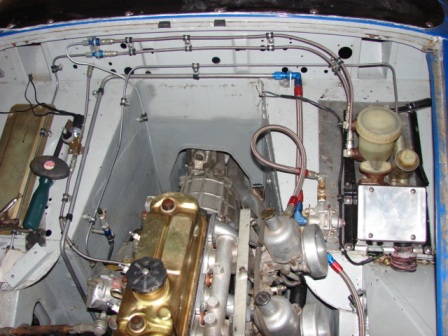

Kevin_Shorter
Wray
Our bugeye is running dual circuit brake master cylinder and the other vintage race car we have is running a tilton type peddle setup, but I believe it is running Girling master cylinders. Give me shout if you would like to come take a look sometime.

Wray_G
Jeff,
Is this a later model Sprite brake master cylinder and separate clutch master cylinder?
It looks like there are 2 brake lines coming out of the brake master cylinder which means it is a dual circuit brake master cylinder?
This is the type system I probably need to use with the stock front MK4 disc brakes from my 67 parts car.
The master cylinder on the parts car I have doesn't look like the one in your picture.
My parts car master cylinder has a metal reservoir with only one brake line, not the plastic brake reservoir like the one on you car.
The clutch master cylinder on my parts car looks very similar to the clutch master cylinder on your car.
I probably only need the later model brake master cylinder like yours. This would be a lot less modification than using the Tilton pedal assemblies.
The brake actuation rod on my parts car may or may not be the correct length for the newer master cylinder?
There may not be much modification required to use a brake master cylinder like yours.
If I mount everything on the right hand side of the car I would have to fabricate new brake lines anyway.
Thanks for the picture.
This looks like the way I need to go with my daily driver.
