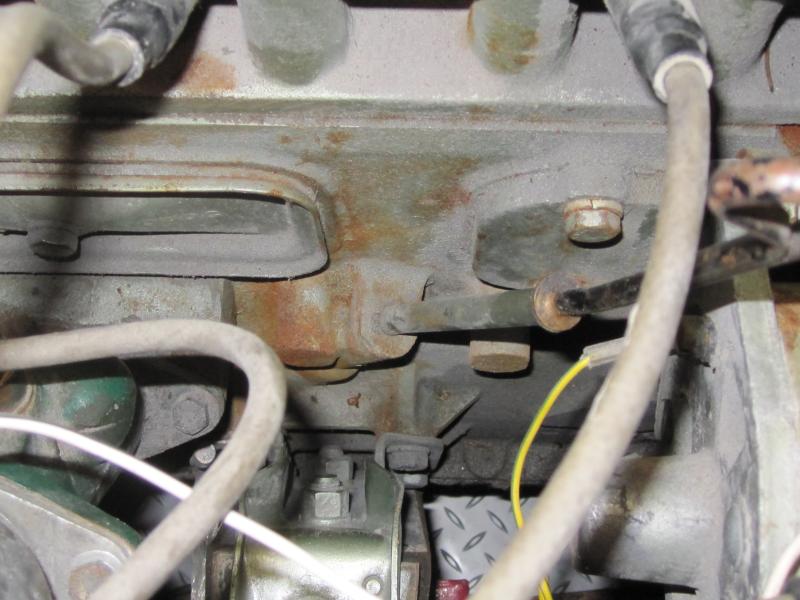

Steve, That raises an interesting issue. The complete number on the plate on the engine, with an F prefix, matches that on the British Heritage Certificate for this car - a 1963 MKII. But the former owner of the car says that the engine block is a late BJ8 block. The reason he thinks that is because of the location of the dipstick. On this car, the dipstick is directly above the engine mount, instead of behind the engine mount. See attached picture.
Does this sound correct? Is this in fact a later engine? Can anyone tell me at what serial number or in what year the dipstick location moved forward to above the engine mount?

blueskies, that is a BJ8 engine. The dipstick was behind the engine mount from 29F engine /H101 to 29K engine /H278 (and for French-spec 29FF engines /H101 to /H164). For 29K engines above /H278 (and French-spec engines from 29KF /H101 and 29KFA /H224), the dipstick was above the engine mount. It would appear that someone has removed the serial number plate from the BJ7 block and reinstalled it on a later 29K block. If you send me a photo of the serial plate, I can tell whether that has been done. The only reason to do that would be to suggest that the engine in the car is the original. That's why I object to serial number plates being recreated and installed on engines that are missing them because once the serial plate is gone, in most cases, there is absolutely no way to be sure the engine is the one that originally had that number.

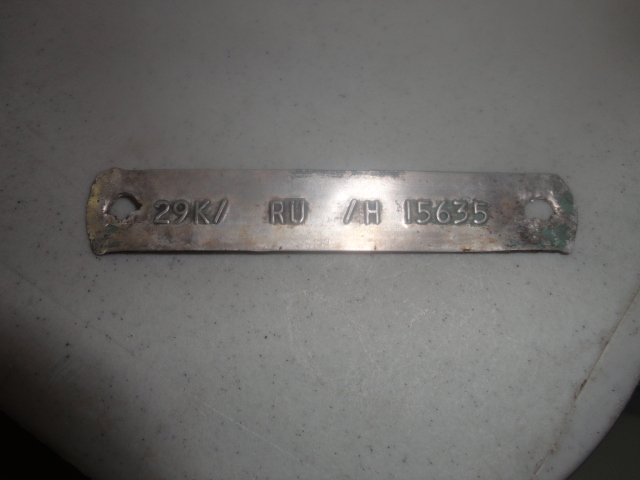

Here you go. Does this tell you anything? The number is the same as on the British Heritage Certificate for the car, a later BJ7. The car was manufactured in June of 1963, but titled as a 1964 model.
It seems surprising that anyone would have gone to the trouble to switch engine tags. The person I bought the car from had it for about fifteen years, and he bought it as a project, with this engine in place, not running, needing rebuilding. When he bought the car, it was very nearly rust free, but otherwise rough and unrestored. I would not think that the car at that time had a value high enough to encourage fakery. Assuming that someone swapped tags, that likely occurred decades ago.

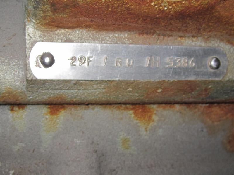

Here's my original one for my '67.

The numbers and lettering don't look right to me. The sizing and spacing is inconsistent and some of it appears to be correctly reverse stamped, but other parts don't. It also looks awfully nice and clean compared to the rest of the block in that area.

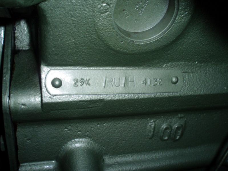

The engine serial number plate is an original plate. The lettering and spacing are typical, and sometimes plates are found with some numbers stamped into the plate from below while others are stamped from above. Another example is attached.
To me, this indicates that the basic serial number was stamped into the plate from below, while the rest of the number (for example, the part indicating whether the engine is to be mated with an overdrive gearbox and whether it is a low or high compression engine) was stamped at a later time from above. As with so much else in the factory processes, the way things were marked is not 100% consistent. It appears that there is no way to tell whether this BJ7 serial plate is original to the BJ8 block it is attached to. The last BJ7 engine serial number used was /H6188, so /H5386 is a relatively late BJ7 number. That leads to the possibility that production of BJ8 blocks was already underway and one could have been used for a BJ7 number, but that is just speculation. Production of these cars and installation of their serialized parts did not fall in strict numerical sequence. The first BJ8 got engine /H571, which has the longer dipstick of later cars, while the 9th, 10th, and 11th got the shorter dipstick of the BJ7s.
