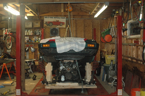

I used a chain hoist to raise and lower the engine/tranny onto a wheeled cart, two scissor jacks to raise the body and made wooden body stands to support the body at the required height. I also used my lift, but the process would work without it. The attached photo shows the basic approach. I have more photos if you would like them.

PATR8
I have headers on mine and do have to remove the passanger side or they get caught up on the body rails. Just a little FYI
