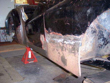

We replaced the floor pans, inner & outer sills on this later TR3A. I MIG welded new sheetmetal to the lower 10" of this fender (off the car), fabricated the new piece that secures the bottom of the fender with the three bolts to the bottom of the inner sill and when we mounted it, there was too much metal in our patch. Maybe it was only 1/16 to 1/8", but the fender bulged out and we had to re-cut it and re-weld it (on the car) along the cut so the bulge was no longer there.
BTW, repair patches like this for an Austin Healey 3000 are available and the patch comes with a tube of adhesive so the patch can be "glued" along the top horizontal joint without any welding, therefore without any bulging or distortion. All that is required is to cut the fender, leaving 1/2" along the cut, impressing a thin step into the lower edge with a tool like I bought from Eastwood and then gluing on the new patch. After gluing and curing, (usually overnight) the repair was flush all along the joint because of the step created behind the cut edge.
Andrew Mace
I realize it's possible to do so, but I would think that removing the fenders would a: make it easier to fit, shape and finish off any patching; and b: make it easier to do a proper and more thorough job of priming, painting and rustproofing the back side of the fender to prevent future problems?
Don Elliott
Andy - I fully agree with the last part. After I finished that fender, plus all the others, the doors, etc. I took them all off to have them finished and sprayed off the car. That way, every hidden area insiade and behind gets painted plus the undersides of the fenders. This saves a lot of trouble the next time it needs to be done.
MDCanaday
IMHO taking the wings off for repair is the worst of ideas.I always leave them in place so that any tensions in the steel can be addressed as the repair is done.Failure to do this will likely get you an "oil canned" fender,that was fine on the bench but goes boink,boink on the car......The wing must be removed for proper corrision protection after the weld/glueing operation is completed.(I prefer the hybrid approach of gluing in the flats with welding in the critical areas at the edges/corners).
