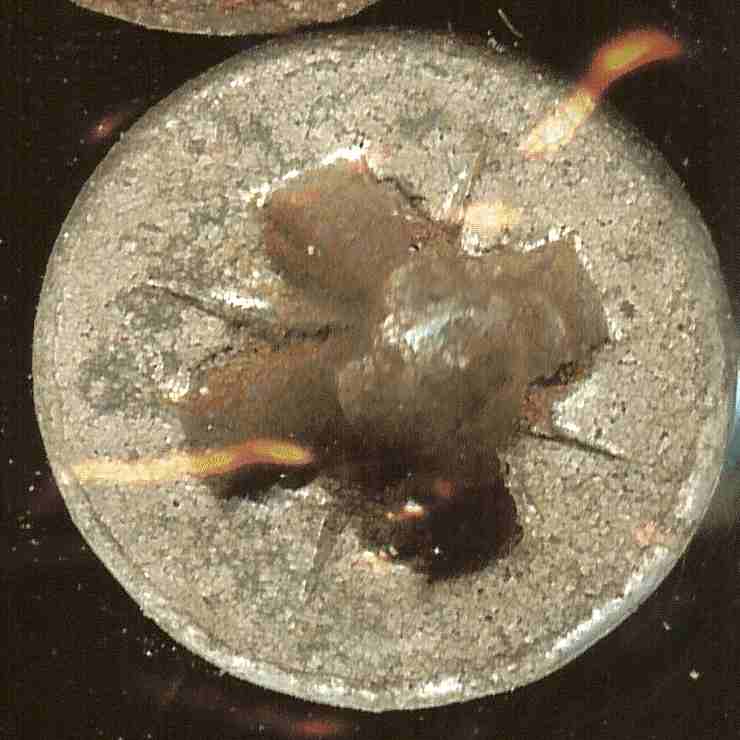

As I review your post again while trying to upload a picture, I am realizing that I do indeed have a posidrive screw. The bolts when scanned and blown up by 600% clearly have the 4 lines mentioned in the articles. Those articles were very helpful thank you. Ugh. I wish I had known to get the posidriv screwdriver head as I think I have ruined the heads. The detail required and tools is somewhat overwhelming. I wish there were manuals for the extreme novice like myself that could outline these nuances.

Re: Removing damaged bolts & screws: posidrive
Well, I stand somewhat corrected. within the Austin Healey 100/100-6/3000 Restoration guide they have an appendix specifically addressing Posidrive screws. I wish that there were specific references within the door section within the book as well as the AH service manuals. I will need to re-read this book before continuing to see what else I have missed.
