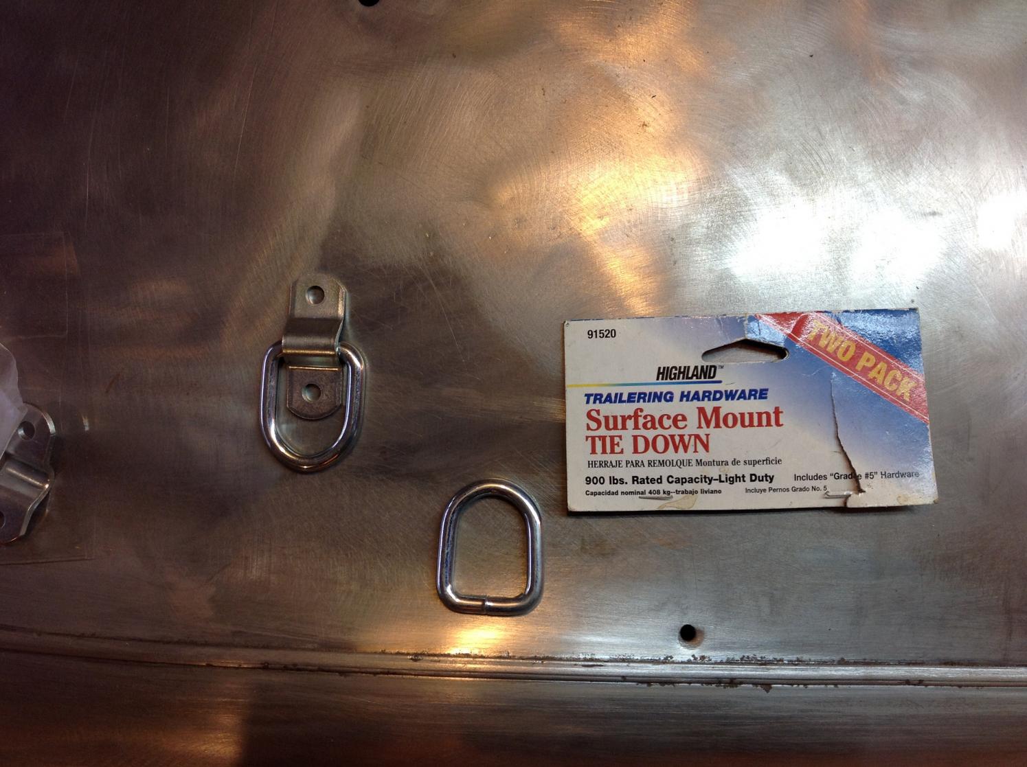

these are the tie down mounts I use on my trailer and they are rated at 900 lbs. they could be easily installed thru the rear bumper bracket near the 3 bolt holes. Once mounted they don't hang down or rattle. You can also use small tow hooks in the same mounting spot or on both ends.

I put these together this morning and they are drilled to fit the front two holes of the bumper bracket mount. The D rings are rated at 900 lbs and drop down just enough so you can tie or clip a strap to it. I'll get them in the mail sometime this week so you can see if they work for you.

I used a substantial L bracket about 3/16" thick and cut it in half, ground off the galvanized coating and welded a 900 lb capacity D ring to the end I bent down. I drilled holes to match up with the bumper bracket and slotted the middle hole since I have a difference in the measurements between my 1960 and 1963, kinda universal. You might be able to use the original bolts, but I would go a 1/4" or so longer.

Got a package from Rut today in the mail. It was two rear tie downs for a bugeye. A strap with holes cut for the bolts that hold the rear bumperettes on with a loop on one end as shown in a previous pict Rut posted. All painted flat black.
These guys are the you know what, this is the way to go. With the front tie downs from a late model MG and these for the rear from Rut a person does not even need to bend over to tie down a bugeye, how wonderful is that.
Could not wait, had to go see how they worked. I need to bend the end with the eye down about 45 degrees. No prob. Will fix that tomorrow. The bumper bracket requires the additional bend.
