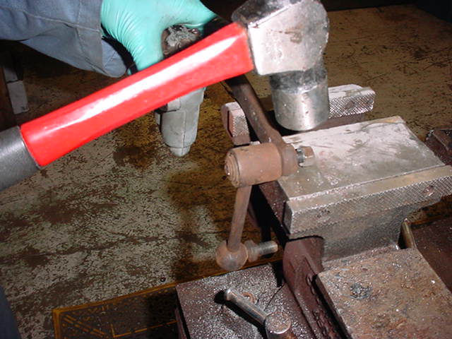

Oh boy... I'm going to try this attachment thing.
Anyway, this picture shows where to strike the shock arm. With nut loosened, support and smack the arm perpindicular to the hole, or pin. You are trying to "oval" the tapered hole to "squeeze" the taper pin a little. You should not need the hit the threaded pin at all. Maybe a tap. But smack the arm in step 1 hard, several times. Leave the nut on loosely unless you're a gambler, ...and a good aim. (boy, I hope this works) Peter C.

Hi Peter,
The attachment worked! I was wondering how the pros handled this job (and now that you mention it, used this technique on tie rod links many years ago). Thanks for sharing your expertise! /ubbthreads/images/graemlins/hammer.gif

Yeah Peter C, but for the problem stated I think Wana's solution is the best. Why beat it to death if you don't have to.---Keoke- /ubbthreads/images/graemlins/hammer.gif
PeterC
Keoke, Wana used the same technique, I think. At least we discussed it when he got the shox. I can read his description that way.
