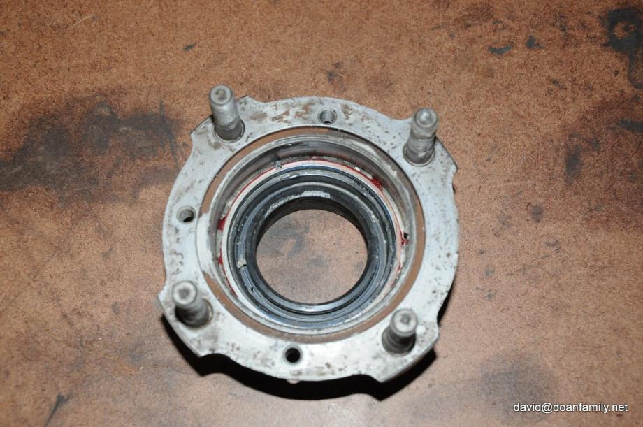

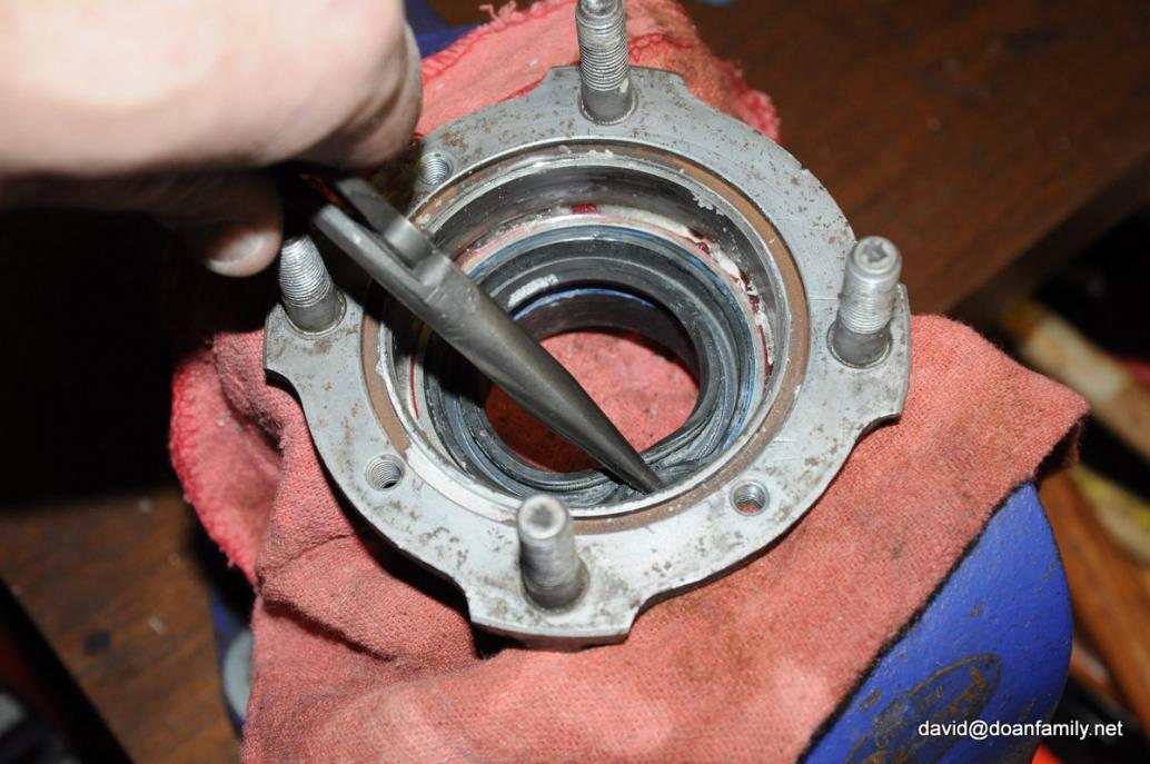

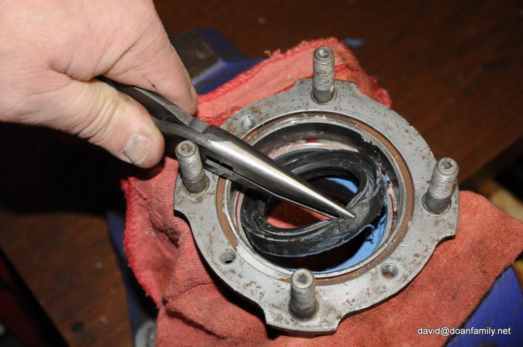

David_Doan
I'm currently doing the same thing.
  1. Yes, the seal is behind the bearing
  2. Yes, knock it out with a bearing driver or a deep socket that fits on the inner race. If it comes out easy, you can likely re-use the old bearing. If it comes apart or takes a lot of force to get it out, it will have to be replaced.
  3. The bearing pops out by driving the inner race, the seal is a PITA.
If anyone has tips on getting the seal out, i'm all ears...

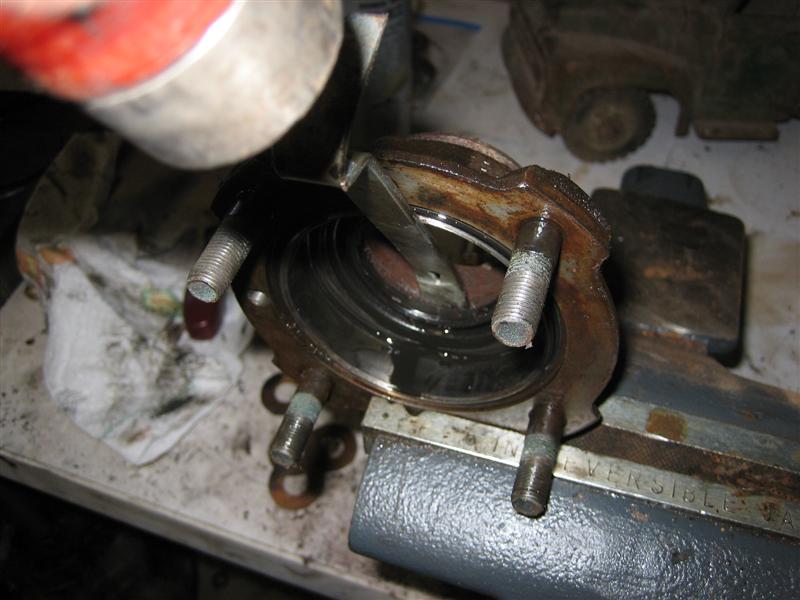

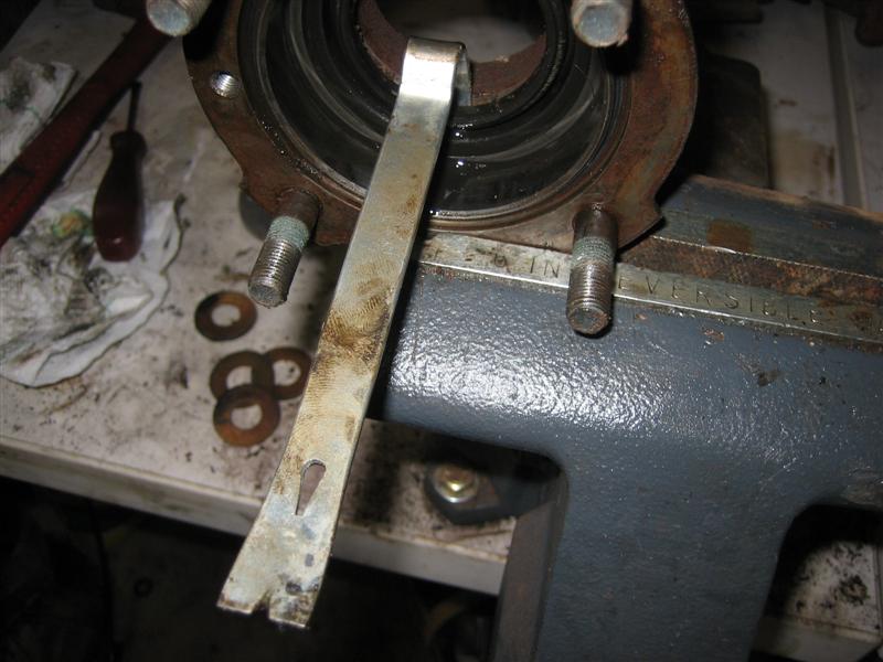

markberry
Use a Common screwdriver wedged between the hub and the seal then beat it like it owes you money. the outside of the seal is essentially a metal cup filled with the rubber lip seal. You need to get something between that cup and the hub. i took a torch to one once and just burned out the rubber and over heated the thin cup until it warped and let go

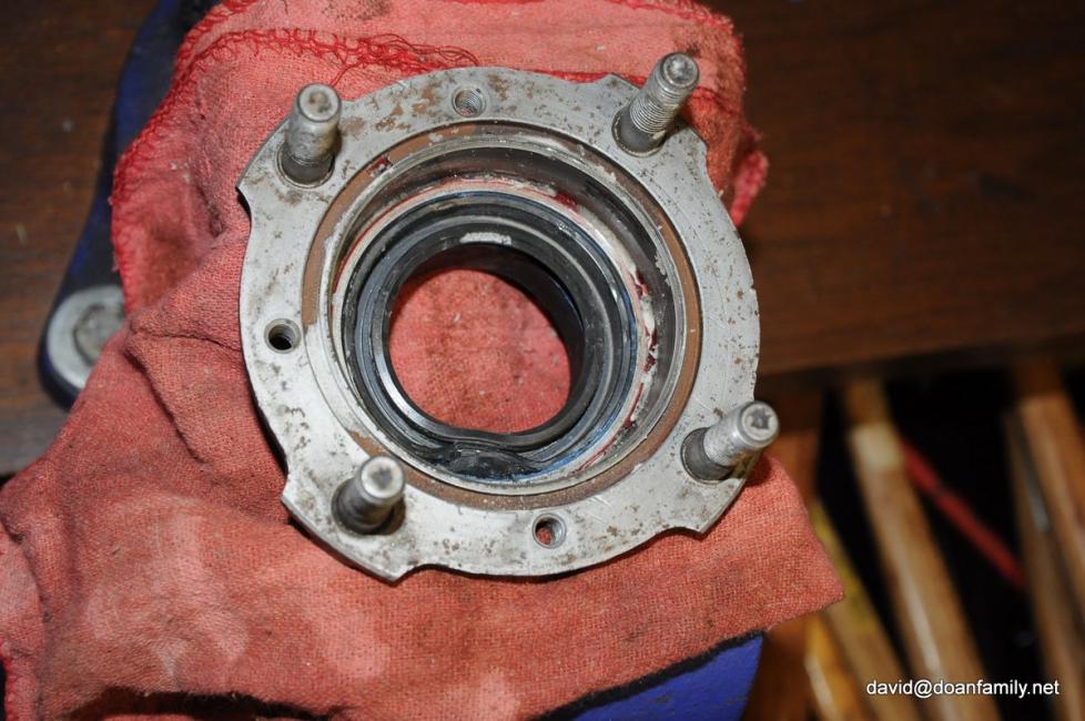

David_Doan
Thanks for the tip, it was actually a lot easier than it looked. I did not realize that the seal had rubber on both sides.
I believe that is often called a miniature "wonderbar".
