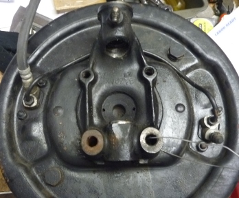

Thanks for the replies. I was hoping to avoid removing the MC, but maybe it will be necessary? It seemed to be working fine before I did the front brake work. One other thing and I'm not sure if it matters...If you look at the attached photo you will see that the new bridge pipe is oriented under the wheel cylinders, which is how the old one was oriented when I bought the car. The manual shows it oriented above the wheel cylinders. Perhaps it was done this way to facilitate bleeding?

I think the bleeder screw should be at the highest point possible. An air bubble can float above the bleeder for quite a while.

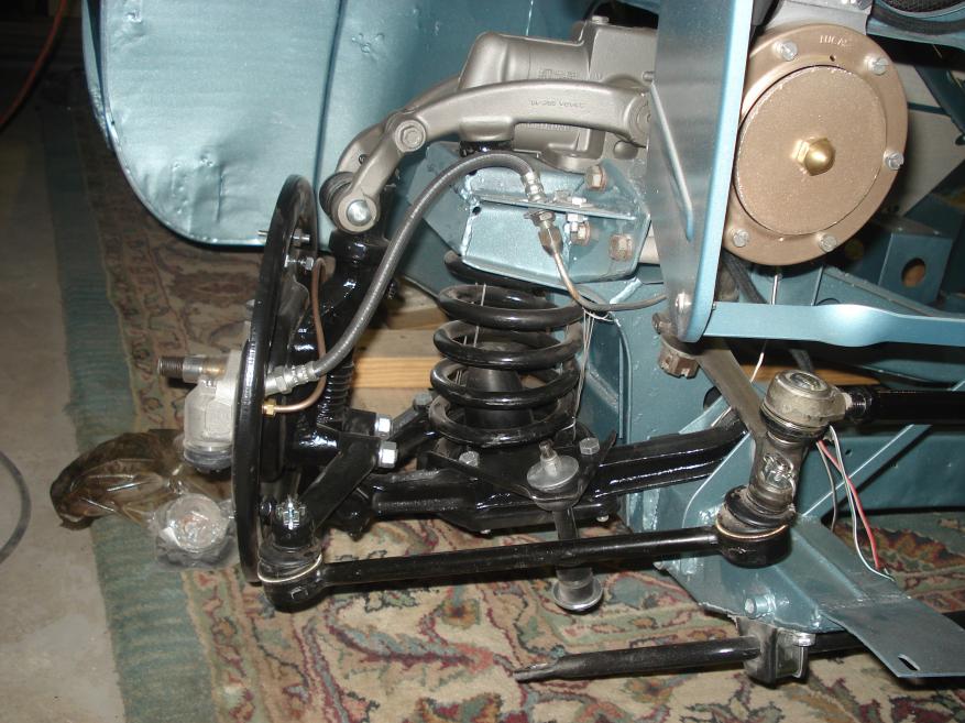

Here's a picture of one of my BN6 front brakes just removed a couple of months ago - bridge pipe is on top:
I found in the past in order to prevent air from entering the system during the bleeding process, it is necessary to open the bleeder screw enough for the fluid to flow, then hold the screw against its socket so extra air isn't admitted. Also my BN6 would gravity-bleed OK. Do in this order: Driver rear, passenger rear, driver front, passenger front. If you haven't bled all 4 positions you'll need to do that.
Don't know why pipe position would make a difference but it's the only thing you've changed therefore is suspect.

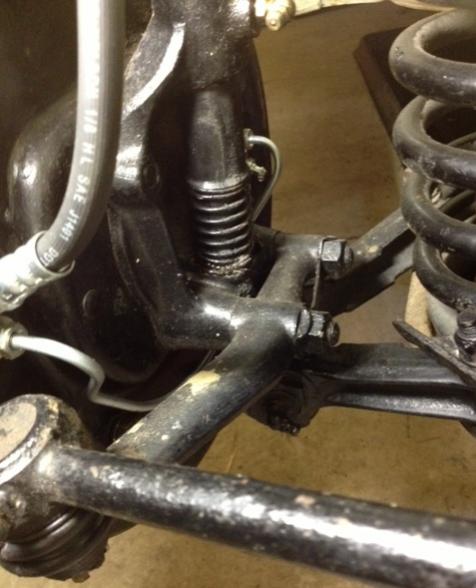

1957 BN4 crossover pipes also run up top. Never gave it a second thought and the brakes bled easily with a nice hard pedal. I use a vacuum style air powered bleeder first to get fluid at all the bleed screws, then I use an assistant to do a final pressure bleed the old fashioned way. It seems to work every time with good results. In my experience if the pedal pumps up fine but then slowly travels to the floor on its own with steady pressure, it means the master cylinder is bypassing internally and needs rebuild/replacement.
