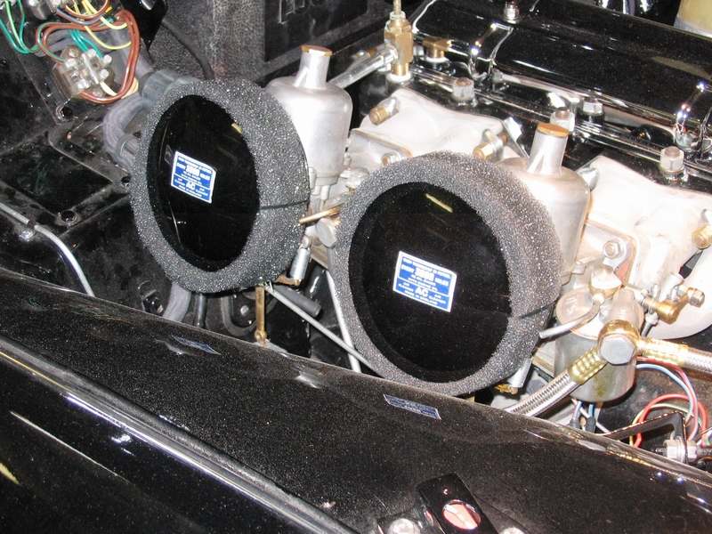

Don Elliott
I made mine by cutting a $15.00 foam filter I bought at Sears for a wet/dry vacuum cleaner. I add AMS "Oil for Foam Air Filters". My only concern is checking the colour of the sparkplugs till I get the lean setting I want on the adjustment under the carbs. Mine had been running rich before I put new bushes, spindles, needles and jets in my SU carbs. But I'm very close now.
