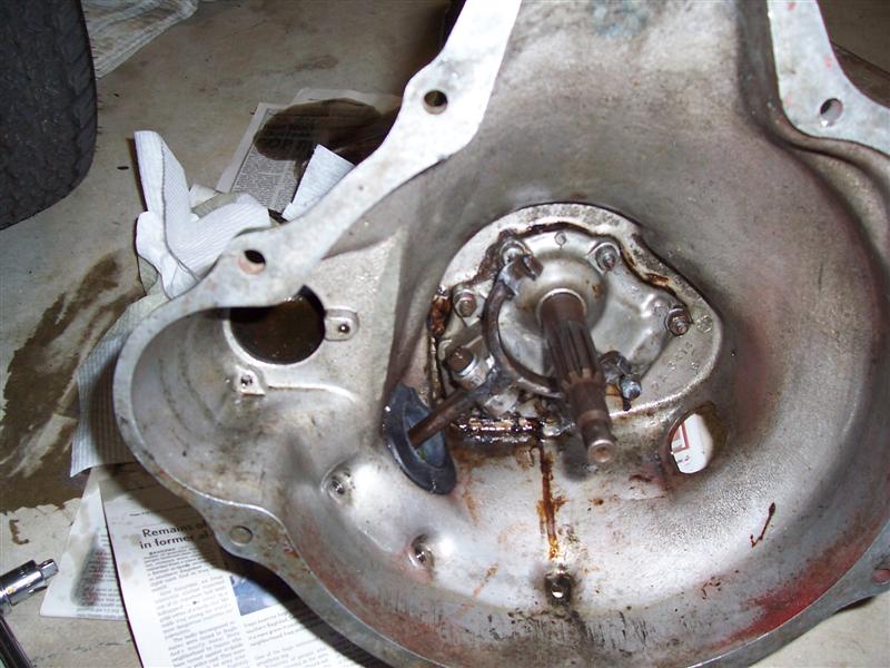

Ok this is a pic of the inside of the bell housing. Guess what I think it looks like the cover is leaking. I know I did not assemble it in that kind of shape. I think first thing that plate cover what ever needs to come out and be resealed.
Hay, I wonder if that bad clutch caused that with all the excessive pressure when I was trying it. It does pivot on the plate and could have caused the problem. Yep I have another tranny just in case I need a new plate. I wonder what I will find. Now if I can just hold off till morning to check.

Man, I'm hoping that I don't have the same problem! How did you know that you had the wrong clutch in place Jack?
Cause no matter how hard I pushed nothing happened. And I push hard. I think, in fact am sure I broke the seal loose or cracked that plate but can see no crack, is dark out there.
Jack, by all means remove the cover and check it carefully for cracks or warpage. If it's OK, just reseal and reinstall. It's cheap insurance, if nothing else.
