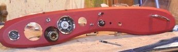

Hey man, you are ahead of me!
I'm just finishing the dash, then have to start it up, etc, then interior. I'm OEW too with the red interior.
My goal is the woodland, ca british show on May 23.
