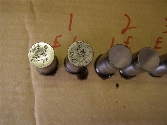

Sorry to hear about your problem. In order to help we would need some pictures to show the condition of the lifter(s) in question.
BUT first.....I don't believe that you will cut a push rod to fit a tappet for any reason, unless you shaved the head and changed the head thickness considerably. And even then, you would replace them with shorter rods that are readily available.
Now for an example, is this what you are referring to as "pitting"?

My tappet had very few pits in it; nothing like your #1 set. Similar to your #2 intake, but with a couple of more pits.

I'm glad that your lifters did not look like mine. The two lobes were beginning to wear down as well.
