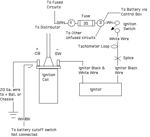

Is your pert. connected exactly as on the attached drawing?
Can you describe exactly where your VM is connected?

By the way, Good drawing Dave. I have a question about it though. Would the coil have the negitive side connected to the switch on a BJ8. I'm thinking the BJ8 already had the electrical connected with negative ground then the coil would have negative on the breaker side. I always get this mixed up.
Dave Russell
Yoda - R.I.P
To my knowledge ALL Big Healeys had positive ground. So negative comes from the switch.
A battery that was full charged & still being lightly charged, would have at least 13.5 volts on it.
I don't know where the VM is actually connected though.

I double checked today and verified I have installed the ignition exactly like your diagram as best I can tell. The white wire I spliced into the black Pertronix wire is the one that connected to the - post on the coil.
My VM is connected to a spare terminal on the top 35 amp fuze block at point 4 on your diagram. This is the switched side and as I read about on this forum, gives me a dual indication of charge and condition of the fuze.
