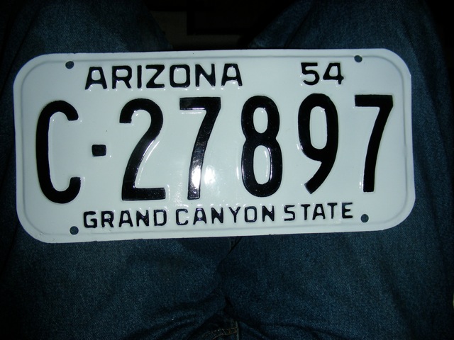

Restored this from a grungy but straight plate ($15 on eBay).
Bead blasted
Powder Coated black
Spray painted with white lacquer from the hobby shop
Wiped the face of the numbers/letters clean with lacquer thinner
Clear coated for durability
This one is on my BN1. I did 2 more Texas plates the same way for my sons Bugeye.
