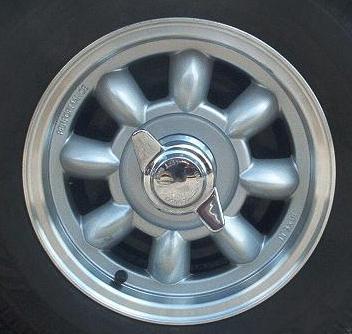

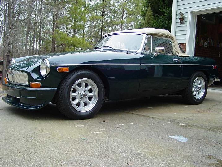

7" are too wide for stock MGB fenders, shame you didn't talk to me first, these are 15x6 with the proper offset for a MGB, and as good of quailty as a Panasport anyday of the week, and you could have saved some money, 15x6s are 180.00 each, 14x6 are 165.00 each.
The picture is of Paul Slice's gorgous MGB (he post here). You can see bigger version of it on my website.

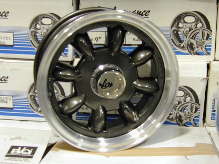

Here's a couple of shots of the knock-off version, or spline drive version, we're the only company to put the adpater on the back side, like the works Leman cars had on them. The splined wheel are more expensive than the bolt on wheels of course, but still less than out competitors.
