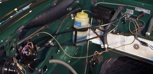

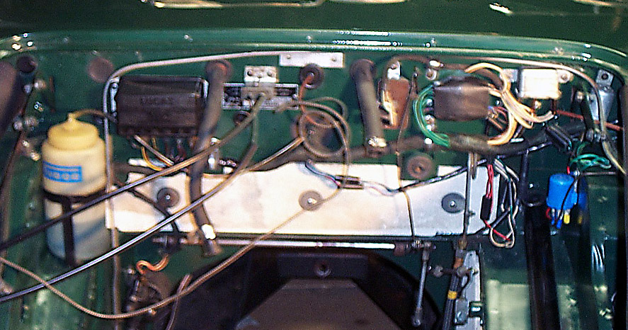

shorn
Here are couple of pics

kodanja
very nice!
