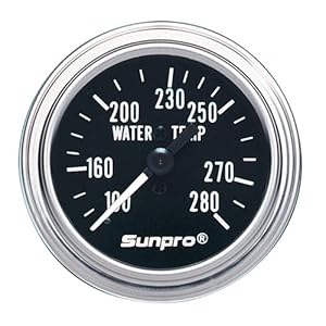

If you don't care about appearance, then there are a variety of aftermarket gauges that will fit and work. For example this one will fit directly into the dash & Tstat housing. The only modification needed is to hook up the line for the light.
https://www.amazon.com/Sunpro-CP7975-Mechanical-Water-Temperature/dp/tags-on-product/B00029JXQ6
But the TR4 gauge should work fine, if you also include a voltage stabilizer. That's what I use now.

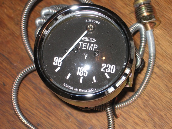

There has been several listing on Ebay of a "clone" that looks very close to original. Other option is to rebuild a used one or suffer the looks of a aftermarket which are readily available. I'm using a cheap A/M (20.00) until I get my original rebuilt. Originals do come up on ebay occasionally.
martx-5
I bought one of those clones. IIRC, it was about $75. It does look very much like the original with the exception of the needle. It's a bit thinner and pivots from a hole in the top rather then swing through an arced slot. Also, there is a separate hole in the back for a light bulb rather then being lit externally through the slots around the casing. The font is also slightly different, but I think it's a reasonable alternative unless you're looking for originality.
I still have my original that I will eventually have rebuilt, but for now, the clone looks like it belongs.

I did repair my original gauge using the procedure outlined in this link. It worked for about two years, and then the soldered repair joint gave out...most likely from vibration. I've decided to send it out for repair...one of these days. For the time being, I have the clone.

As I stated earlier, I have one of those clones and it works properly. When I got it, I put the bulb in boiling water, and it registered 212°F.
Anthony_S
Hey all,
I will concur with martx-5....just recently I was in a position to either have my gauge rebuilt which was about 130.00 for the cheapest place or buy the clone as shown above for 75.00. I decided to go with the clone and I am pleasantly surprised with it. If you are really looking you can tell it is a bit different but it blends well with all the other gauges. It works properly as it should. So if your not looking to impress judges but don't want it to stick out like a sore thumb and want to save some money I would recommend the clone.
