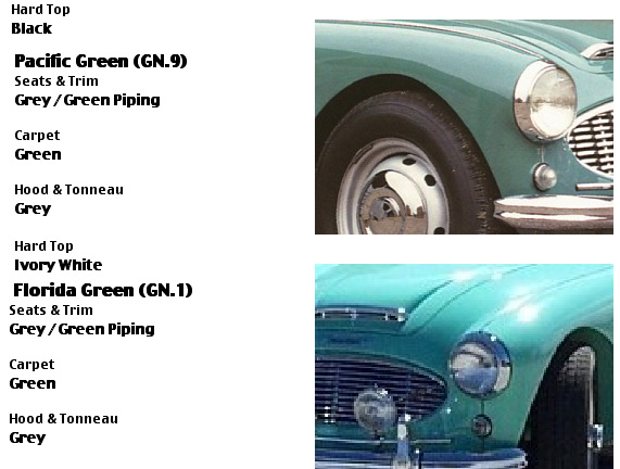

[ QUOTE ]
[ QUOTE ]
Bruces BN2 is florida green.
https://www.britishcarforum.com/ubbthreads/photopost/showphoto.php/photo/2113/cat/508
D
[/ QUOTE ]
Sorry but this car is not Florida Green.
Florida Green is a light pastel green.
I believe the car shown is Pacific Green.
[/ QUOTE ]
Hi Alan,
Bruce's car comes a lot closer to Florida Green than it does Pacific.
D
So, if the car is somewhere between Florida Green and Pacific Green, does that make it "Kansas Green"? Or if, as you say, it is closer to Florida Green, I guess that makes it Arkansas Green or maybe even Alabama Green?

Thats a good show and that is Florida Green as was pointed out by others. The two cars shown are the owner's interpretation of the original colors.---Keoke
