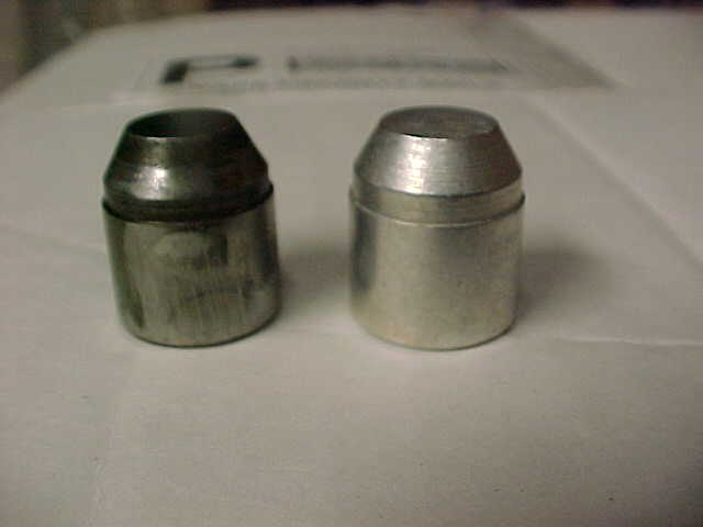

randy,keoke was kind enough to give me the specs on my type pump it i checks out ok, i reassebled the pump submerged the pick up end in a large container filled with oil and while usind an adapter i made from an old 1/2" paddle drill bit and a cordless drill i turned it over, even at very low rpm this thing pumped like a saudi oil rig, i did remove the oil pres. release valve and replaced it with a new one, perhaps the press. is getting by it since the old one is disfigured see atch.and perhaps its seat in the block as well.

7777, What do you mean by; "The old one is disfigured" ?--Keoke
keoke,its difficult to discern from the pictures but the p.r.v. on the left is indented just below the top (the shiny ring) near the middle of its conical circumference and is pitted,as a test i made every effort to securely lodge both of these idividualy in the block with much heaver spring then required-still no pressure,im going to see virginia today and pick up the new pump,ill test it well see what happens then,worn cam bearings,rocker assembly.??? im not looking fwd. to these projects right now!
OK Anthony, That indentation [step] on the nose defines the correct valve for these engines. However, if it is severely pitted its got to go! The one on the right will work but may take some fiddling with the spring. Roger Moment wrote an article a few years back that clarified the differences in the valves and the impact of P.R.V malfunctions on the engine as seen on the guage.I do not know who at the present time carries the correct one. Maybe British Car Specialties.---Fwiw-Keoke
