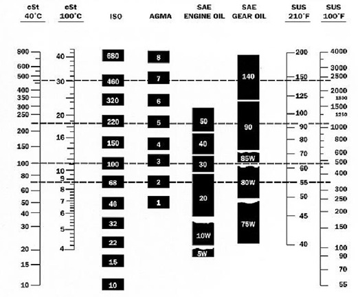

See the attached chart.
An SAE 20 oil at 100F will have a viscosity of about 350 SUS. At 210F it will be around 55 SUS.
A SAE 50 oil at 100F will have a viscosity of about 1050 SUS. At 210F it will be around 92 SUS.
A SAE 20-50 oil at 100F will have a viscosity of about 350 SUS. At 210F it will be around 92 SUS.
Note that gear oils are rated differently. A SAE 90 gear oil is actually quite close in viscosity to a SAE 50 engine oil.

TR6oldtimer
'I are a rock sometimes'.
Of course oils become less viscus when heated. What I really ment to say is that over time motor oils lose their ability to maintain rated viscosity. So in our cars old oil would be less viscous at operating temperature then new. (However, some oils will actually go the other way and increase in viscosity due to sludging.)
As to whether one would notice a change in performance after an oil change I guess would depend on how old the oil was, or more likely it is just the feel good thing of doing it.
