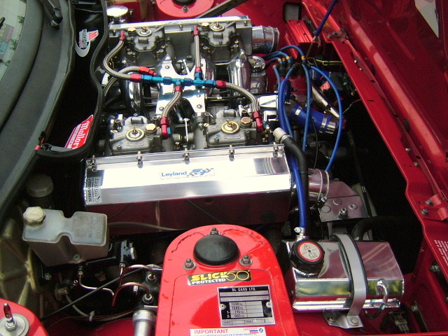

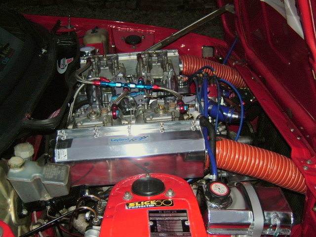

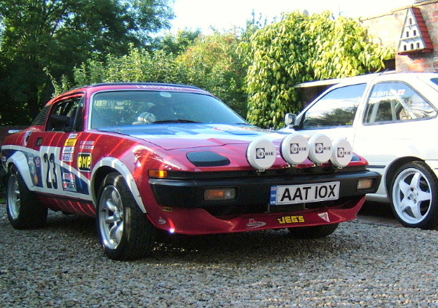

Increasing the displacement in the TR8 is pretty easy. Upping the stock 3.5 to a 3.9 can be done with new sleeves and new connecting rods. Easy engine swaps are the Rover 4.0 and 4.6 (like the ebay item). External dimensions are all identical. That particular engine would require a custom hood, notice how it's off in the photo. Those carbs and air cleaners stand far too tall. I have seen TR8's in England with 4 DCOE's instead, which offer zero hood clearance items. The TR8's in England that I spoke of are Rally clones and can push more than 400hp. /ubbthreads/images/graemlins/driving.gif

Please please please put it in a TR8. As is, and modify the hood for the intakes. Post pictures on the net. It would be the funniest thing I'd seen in years.
Seriously with fi or dcoes that would be a really nice (re: mad) sleeper. Hmm - I wonder how it would fit in here /ubbthreads/images/graemlins/wink.gif
