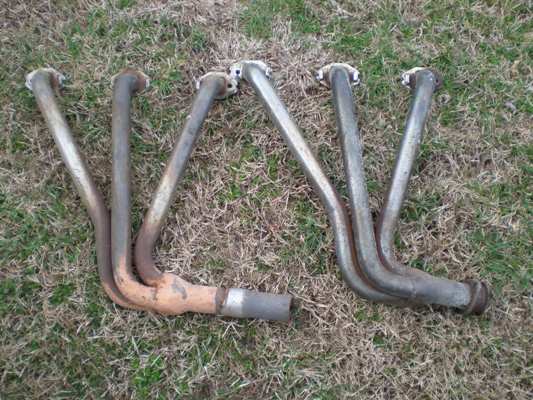

Recognize these?

No, they're MGB....but possibly something special...I know the one on the right will end up on my race car!

OK - this has always bothered me about MG exhaust: I think I can understand #2 and #3 exhaust ports being joined, but how come the tubing size for their common pipe isn't larger than the other two? What law of physics did I miss while I was snoozing? (OK, so I never even TOOK physics!)

Think about which exhaust valves are working when, Mickey...
Mickey Richaud
OK - I got that.
But then why aren't ALL exhaust manifolds like that?
And so much attention is made to equal length/diameter tubing for each cylinder. How come?
jlaird
Length is very important to tune the exhaust pipe for max performance when the pipes are open ie got to the sides like in a drag car. Not so important when they go into an exhaust pipe.
Size is important for performance as well. They need to be free flowing but also provide a bit of back pressure.
Now as to what is magic, I would expect only a dyno could say for sure. But the old time test on length is run em long and cut em where they start to turn black from the burning exhaust. ie the flame you see from dragsters.

&, Jack, if you look at those 2, they're all 'blued' at the same spot towards the bottom of the runs where they tie into the collector.

Four holes and three pipes.........

As I remember from our by gone racing days, a good header design will have a savaging effect, whereas the flow from the "hot" pipe will assist pulling gases from the other pipes creating a smoother flow in the system and less back pressure. Theoretically, all pipes should be of equal length also, but that's rarely the case.

The one of the right that I'm keeping still has that...somebody took it off the one on the left...wouldn't be hard for a muffler shop to reinstall.

I once had a long talk with David Vizard about MGB headers and exhaust flow. The "factory " headers (special tuning) were Long Center Branch, just like the stock cast iron manifolds. The pipe for cyls 2 and 3 needs to be twice as long as 1 and 4. That pipe has to move twice as much gas, and the way the flow works, with the pulses as the exhaust cycle happens, requires the longer center pipe. This is why 1 and 4 join together fairly soon, and the center pipe did not join until the actual collector. I asked directly about whether or not an LCB header gave a measurable performance gain over the stock LCB cast iron part, and he said except for weight , no. This came from someone that wrote books and dyno tested a lot of A and B series performance parts. FWIW, my 2cents worth.

The amount may be very insignificant for a stock engine, but I believe on a mod engine it is definately greater depending on Camshaft (valve timing overlap) etc., etc. etc. variables.
