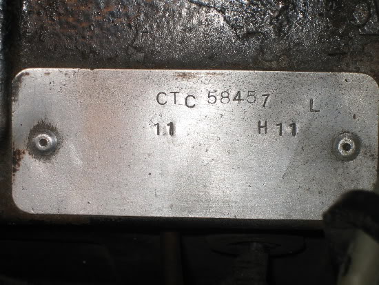

All I got was a plate looking like it was done after a couple pints:

HerronScott
Here are pictures of an original TR4A commission plate (with paint!) and a reproduction. Note that the reproductions aren't totally accurate as they have "Coventry, England." instead of just "Coventry" on the bottom line plus the difference already noted between "The Standard Triumph Motor Co Ltd" versus "The Standard Motor Co Ltd".
Scott
