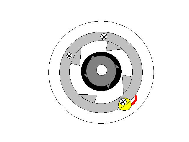

OK, so I went and looked at the distributor. Took off the cap and the rotor, and expected to find another cap plate that would come off exposing the points. Nope. I had a circular plate with 3 screws and 4 triangular points on the inner edge of the circle that surrounded an object that looked like a 4 pointed star, that was evidently attached to the distributor shaft. One of the screws had a wire attached to it. under and around the inner star shaped object was another semi loose collar that the wires were attached to. I have no idea how to get this off to check it. also, when I took off the circular ring with the 3 screws, I noticed that it had what appeared to be a magnetic gasket of some sort, and it had a crack in it near one of the screws. It was semi flexible. I know that when you break magnets, their poles reorientate themselves, so I am not sure if that has something to do with this. I have attached a crude drawing of what I saw.

Well, that is what I am thinking too. If it is the carb needle, then I will find that as well as the whole carb assembly is getting a "going over" next weekend. I will keep poking around. I also have a spare dizzy that I am going to check today for reference, though I think it might be the original, and not the same type as the one in there.
77MidgetMkIV
77MidgetMkIV
Well, the roughness is to rhythmic to be anything other than ignition. I examined the dizzy that I had that came in a box with the car, and it is an Opus type that perfectly matches my shop manual, so I think that was the original. The one in there is completely different. it appears to be electronic ignition type, and has the ignition module mounted right on the dizzy case. Anyone know what types of dizzys were bolt on swaps for the OE stuff that came with the Midgets? If I can get the type, I might be able to find some troubleshooting and part number information.

I have the Lucas Opus dizzy that was in it from the factory too; it came with the box of parts when I bought the car. For educational purposes, I would really like to fix the hitachi electronic one that is in there now. I have found some resources now, but am looking for a good schematic. If I can't get it fixed this week, though, the Lucas is going in.

I completely agree.Checked the fuel line first. It is flowing fine. I am planning on checking the needle as well. The broken magnetic gasket "thing" that I found in the dizzy is curious, though. I am not dead set on the current dizzy being the problem, but it seems likely, given the way that it fires. Pulling the choke does not help the problem, per se, but rather it gets the RPM up enough so that the skip, misfire, or whatever it is, is not able to stall the engine.
Also, the skip, misfire, or whatever, is perfectly regular in cadence, once you listen to it for a minute. I picked up on that this morning.

Yeah. It is a hitachi electronic ignition dizzy from, as near as I can tell, a 1979 Datsun 510 (I have attached a pic from NAPAonline). It is an interesting design. The reluctor is a 4 point wheel that attaches to the end of the cam. Around that is the magnetic pickups, which is also 4 pointed. From what I can tell, when the 4 points align, the coil is directed to issue the charge to the plug, like a regular magnetic electronic dizzy. However, there is a layer between the outer pickup ring and the lower metal pickup plate, like a gasket, but it appears also to be magnetic.
