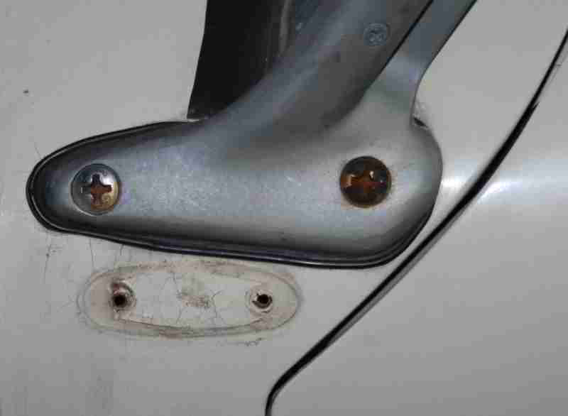

ncbugeye
I'm sorry, I misinterpreted. Yes, I have the centre-mounted mirror as well.
I don't want to hijack your post, but I was asking about these two holes... Ugly and probably almost as old as the car, but almost certainly not factory original.
bugimike
Those look like mounting holes for an outside mirror!! No doubt PO installed! I'm sure a lot of BEs have similar holes!!
/bcforum/images/%%GRAEMLIN_URL%%/grin.gif
drooartz
drooartz
I've got single bolt holes in the doors for useless side mirrors. They'll get filled in when I get around to painting the car some day.
Those holes are definitely not factory original. Side mirrors were a dealer or owner option, and seem to have been mounted pretty much anywhere.
