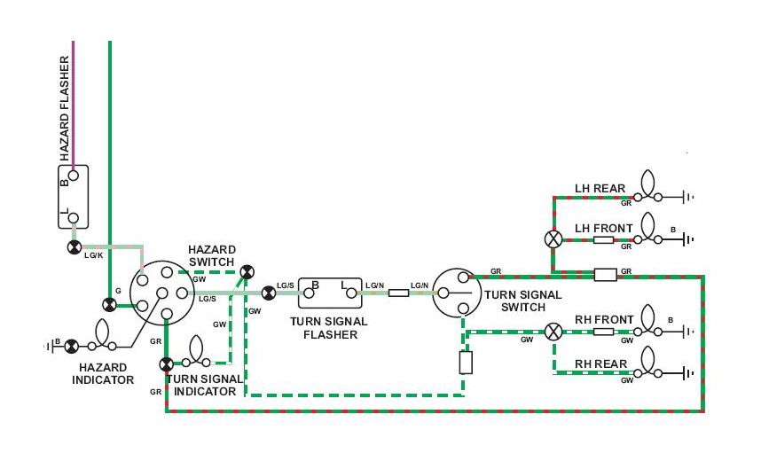

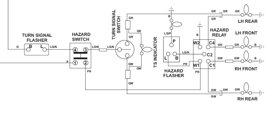

Ah, thanks, Don. The 69s were a bit strange, here's a clip from Dan's diagram:
In this case, power comes in on the green wire (upper left) from the fuse block, and goes through the turn signal flasher first, then through the hazard switch before going to the turn signal switch. If the hazard switch doesn't have good contact between terminals 3 & 4, the turn signals won't work.
