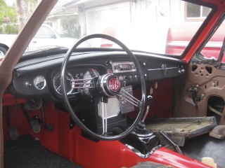

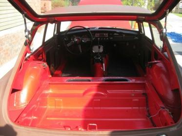

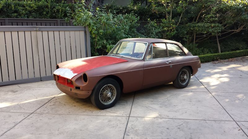

Been far too long since I've had a project. Thankfully this one should be fairly easy as the nasty hard dirty work was done. The car is very strait and not a bit of rust. Not sure when it was last on the road but judging by the cracking sounds the tires made as it was pushed down the driveway I'm sure Reagan or Carter was in office.

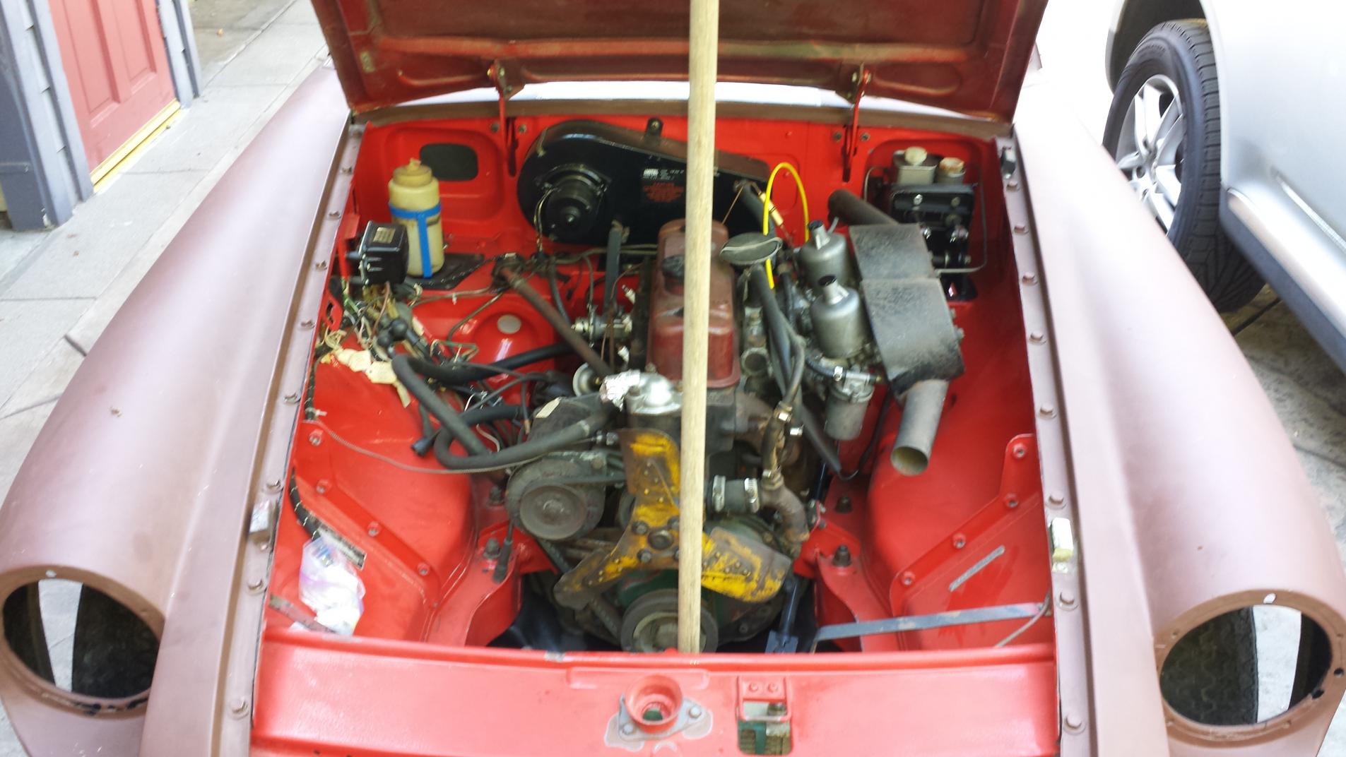

So far I've rebuilt the carbs, replaced the exhaust from the manifold back with a TT, refreshed the distributor, mounted the coil and fixed a miss wired ignition, flushed out the block, new t stat housing and stat, changed the oil filter to an inverted spin on, painted the radiator, installed a new fuel sender and a bunch of other little things. Still need to fix an air leak on the fuel pump and the tach doesn't seem to work.
Car was non op'd in 1986 and most likely hasn't been run judging by the state of the ignition.

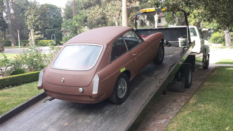

And now it's a non runner and in pieces.

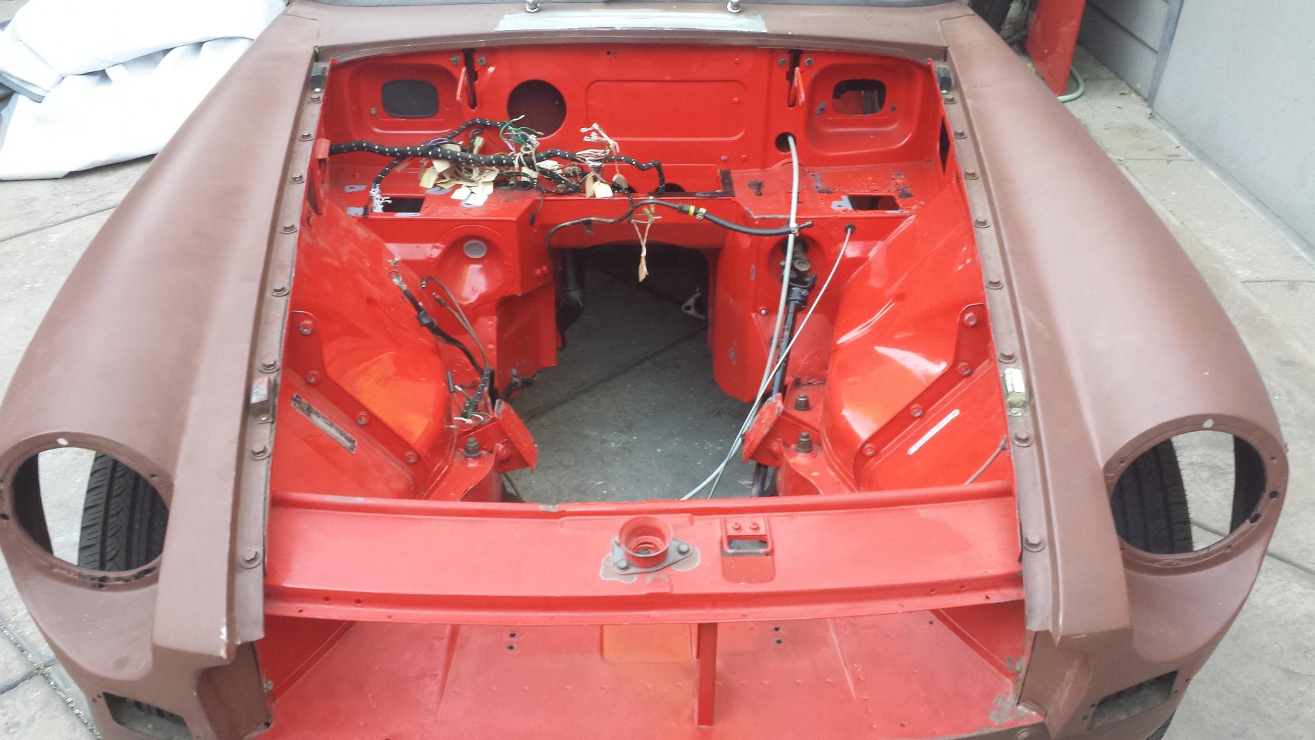

Sent it on it's way to the body shop this morning and the work has begun.

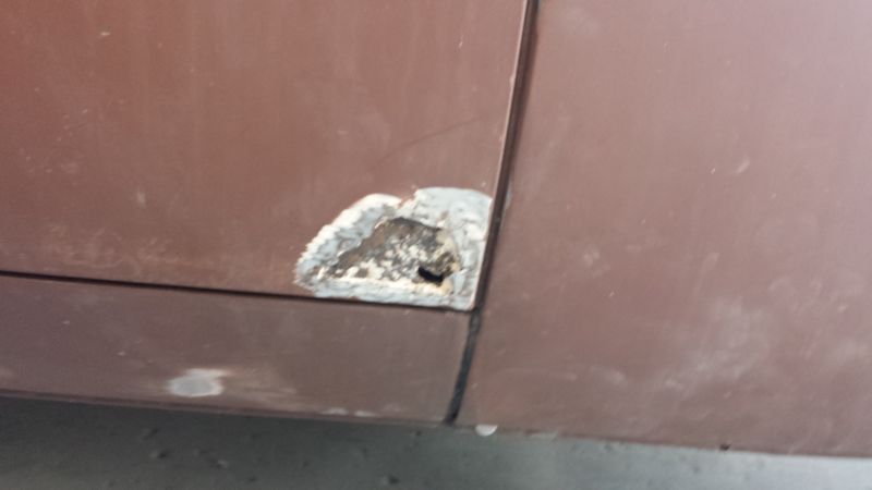

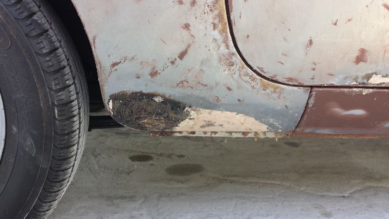

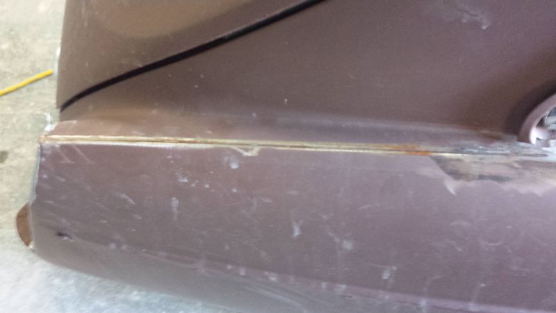

I'm now committed to having the fender mouldings deleted and the shop found a bit of rust in the door.

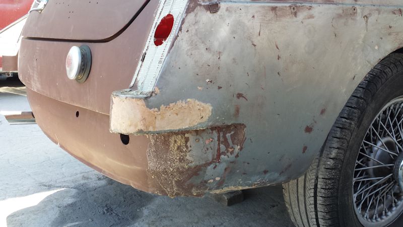

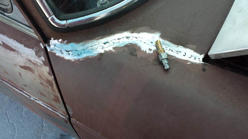

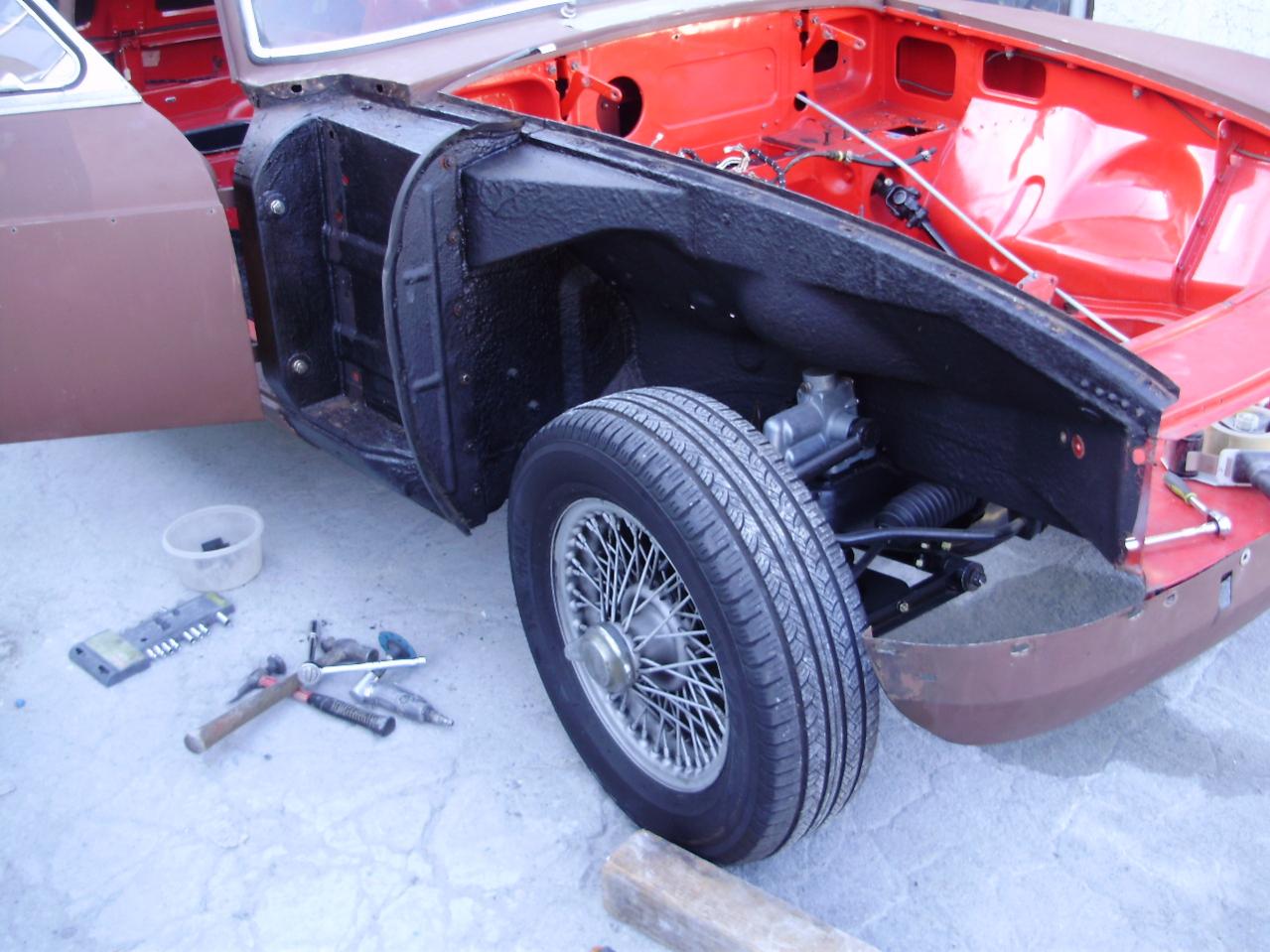

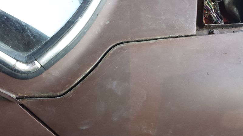

Body shop is moving right along. The dpo did a quick and dirty repair to the dog look but the rest of the car is looking good so far.

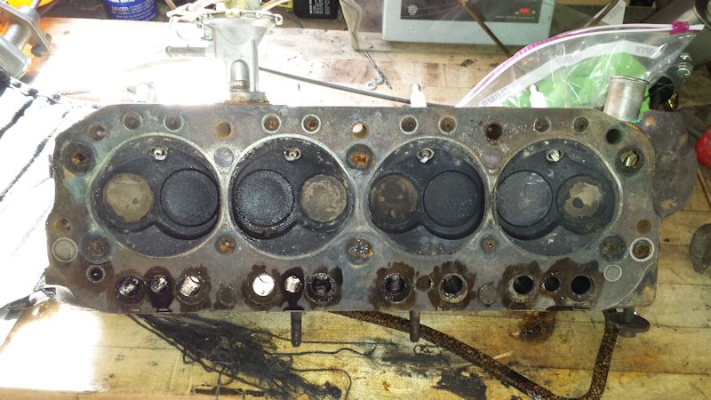

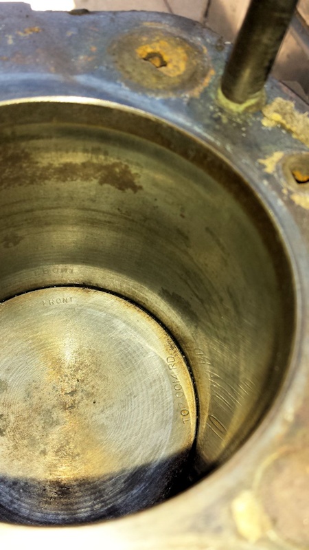

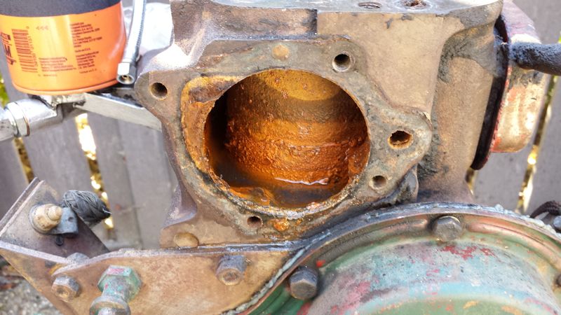

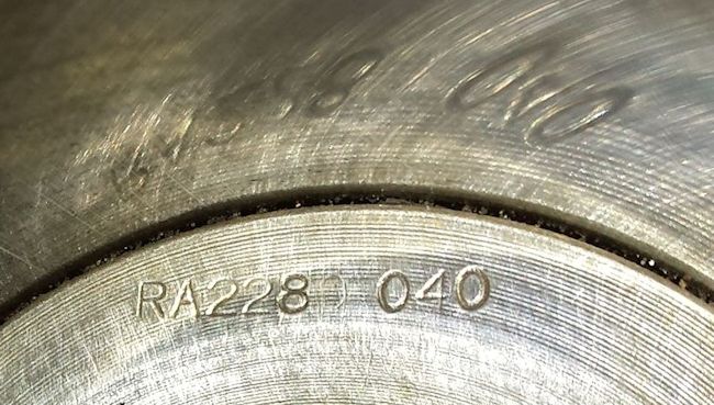

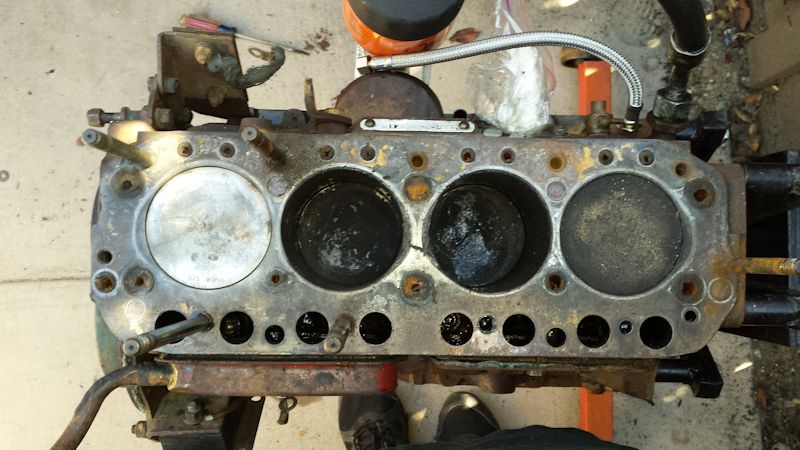

I took the head engine today and confirmed it's been rebuilt at least once in the past. The water jacket is pretty rusty and all of the ports to the head were blocked. I'm glad I didn't run it to long. The head looks pretty good and might just need a good cleaning however the intake on 4 looks like it's hit something at some point in its past. The engine has been bored out to 40 over and it looks like the job has some miles on it. Not much crosshatching visible and it looks like a bit of rust pitting has formed over the years.

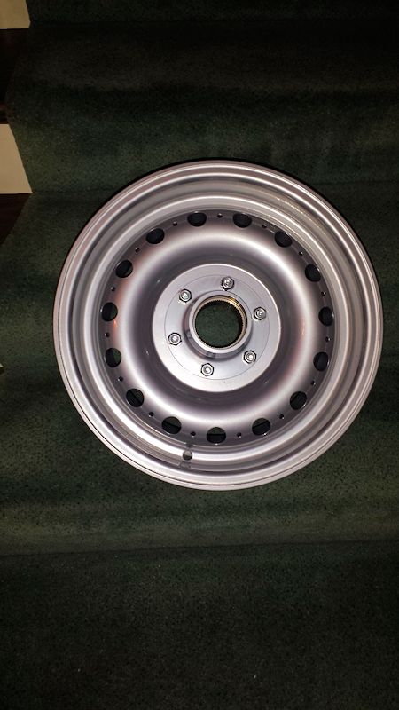

Just about have the engine stripped down and just need to pull the front and rear main caps. Crank is 10/10 and most of the bearings looked great however #4 rod bearing was down to copper. More importantly the wheels finally came in :D
drooartz
Those the alloy Dunlop-style wheels? Love those wheels!
