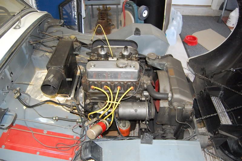

To the point- I'm picking up an estate found 1959 Bugeye. Current owner's husband bought it 36 years ago when he was 18. It was his first car. They dated in it, married in it and enjoyed it for nearly 4 decades. After he passed 6 years ago the car was driven a couple times. On the last outing, the car suddenly lost power just shutting off. No smoke, no funny noises, no coolant or major oil loss (it was leaking a little). It was trailered back to her house and put up on jackstands. It was given a full tank of gas, battery removed, oil changed and fresh coolant put in once parked. She has tried reading the old manuals and trouble shooting it. She wants desperately to take one last drive in it before it goes and I would like to help get it running and take her for a drive in it.
She believes the problem is narrowed down to the Distributor as the coil has power. I didn't pop the cap off to see if the rotor or points were bad...
I also found the clutch and brake pedal won't budge. Would this have a hydraulic clutch? Should I just replace the cylinder(s)?
I would like to know how to identify engine size as well. Where would the serial # on the engine be found? I have the VIN# and would like to know if there are VIN decoders for production date's, etc?

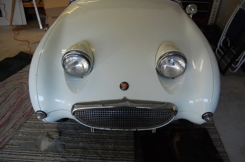

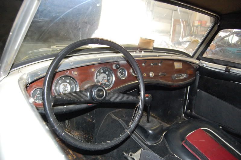

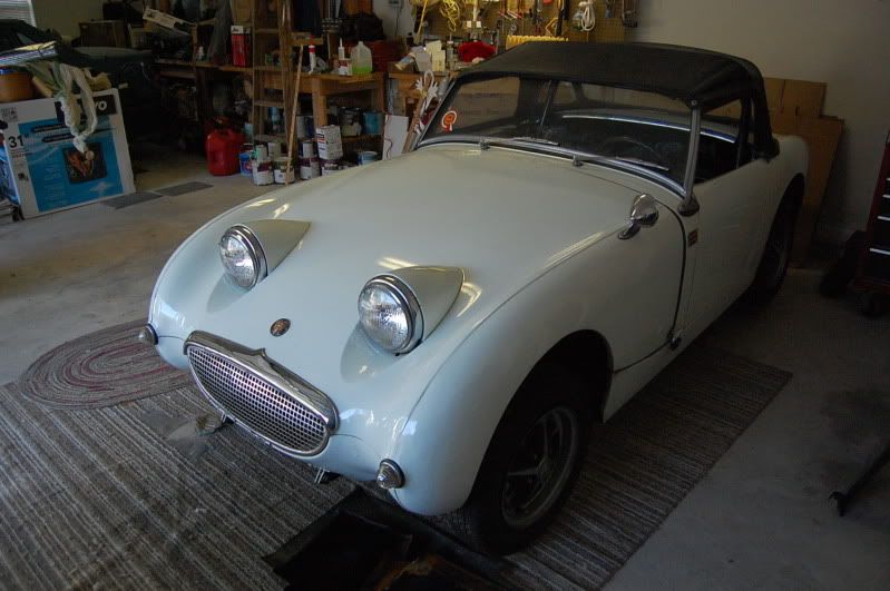

Okay, now for the pics

Welcome to the forum. Great looking BE. Good find.

The engine id is on a plate just below the valve cover on the passenger side at the front of the engine. If it starts with a 9 it is a 948. If it starts with a 10, it is a 1098. If it starts with a 12, it is a 1275. As far as it stopping, it is almost definately an ignition or electrical problem. Remeber this saying! "Lucas electric is the prince of darkness". These old bugeye's are very sensitive to moisture or just plane lose connections. I would check the coil, points, Plug wires into the distributor cap and also check if you are getting power to the coil and points. check points for damage or wear and gap. I also had a similar experience wich turned out to be a cracked distributor cap, which is difficult to see and can only be seen from the inside. Basically, it could be anything electrical, but i would bet on something in the ignition system. On the good side, if you find the problem quickly, it should be really cheap to fix. Nothing on the ignition system is too expensive. If all else fails to find the problem, make sure the distributor is turning and the valves are moving coreectly in case the timing chain broke. The distributor has a seperate shaft between it and the cam. That shaft has been known to either break or slip down into the engine pan if it was installed incorrectly. I always kept a spare distributor cap, points, condenser and a coil as these thing go bad all the time in the stock setup. If you want to improve the reliability, upgrade to an electronic ignition and the new style distributor cap the uses plug in wires instead of screw in wires. Oh and yes, the clutch is hydraulic. The brake issue and probably the clutch issue is that moisture got into the master cylinder which is a dual piston, one for brakes and one for clutch. It is probably has the pistons frozen to the body of the master cylinder from dampness and lack of use. It is an easy fix with a rebuild kit and a small hone. I hope this helps you.
