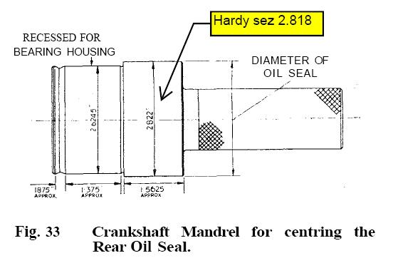

I will need to trim a TR3A crankshaft for a rear seal. Can I do this on the lathe or will it be too unbalanced?

Should be do-able if your lathe is big enough. But I think you'll want a tool-post grinder rather than trying to single-point it; and centers big enough to engage the holes in the ends of the crank. Need a pretty big wheel on the grinder, too, to reach in between the #4 throw and the flywheel flange. Keep the lathe turning slowly enough, and balance won't be a problem.
Personally, I'd take it to a crank grinder anyway, just because I'd hate to screw it up.
But I'm curious, why are you messing with that troublesome old seal conversion, when the new "Mad Marx" version works better and doesn't require machining the scroll off? Seems like a no-brainer to me, especially given all the horror stories of seal conversions that leaked much worse than the original seal (which actually does pretty good if you set the clearances right instead of following the book).
