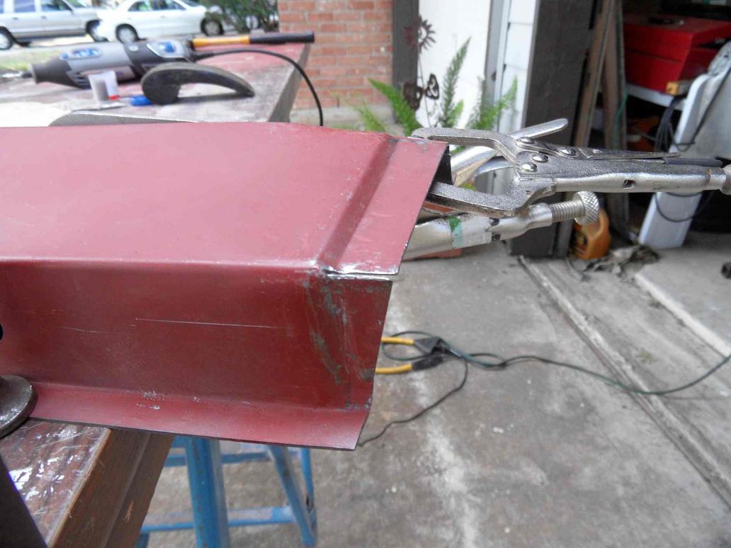

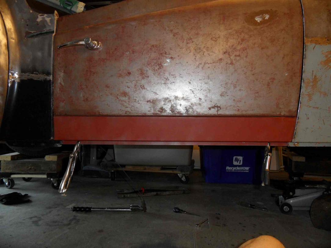

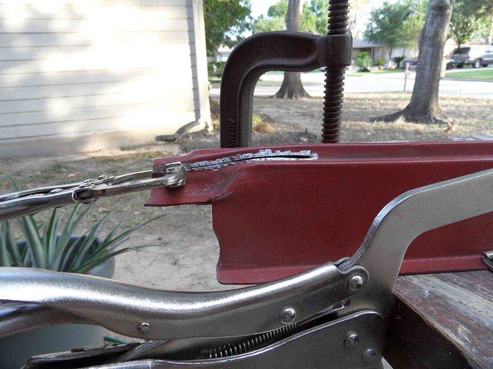

I bought my outer sills off EBay. They were supposedly NOS. Not so sure that was true, other than they were rusty, under the red primer. I ultimately had to shorten them and then make them more narrow, so that they fit up to the quarter panel without protruding outward from the car. Here's a few photos of the welding that was required and a photo of the final product (in progress). And a photo of where I started WRT rust.

Nice Gaps Pat. Cheers Tush

Pat, am I seeing right...that you were able to cut a lengthwise slit and curve the sill to match the original? In other words, you were able to eliminate the need for a bit of glaze to contour to the door?
PatGalvin
Hi John
Not sure that I eliminated too much body filler, but I did indeed make a cut with a die grinder wheel and then was able to push the sill inward a bit and match the flush vertical surface of the sill to the flush vertical surface of the quarter panel. It worked well and the rocker covers are easy to patch and sand, being fairly flat. I don't think I matched the "bow" all that well. I added just a little filler and contoured the rocker, after all the metal work was done. The key thing I was trying to achieve was keeping the front wing skirt, the sill, and the sill cover all in the same plane (except for the bow).
