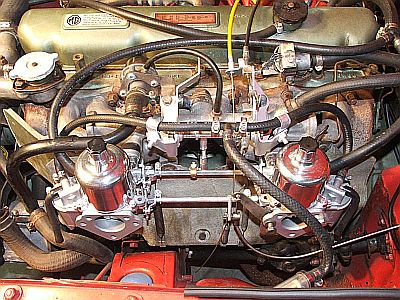

Hap Waldrop of Acme Speed Shoppe (an advertiser here on the BCF)
or
Jimmy Hilton of Texas.
Platinum
Well, opinions are like freedom "parts" but Joe is th' first "Go_to Guy" and Hap W as well. If ya wanna know more, do a search here.
We're of some prejudice, but not without reason. Really.
DrEntropy said:
Well, opinions are like freedom "parts" but Joe is th' first "Go_to Guy" and Hap is the silly NEXT-BEST. If ya wanna know more, do a search here.
Mea Culpa...I neglected to mention Joe Curto, one of the known SU gurus.
I would send my carbs to any of the three gentlemen mentioned in this thread.
Jimmy Hilton did the carbs on both of my MGCs.
