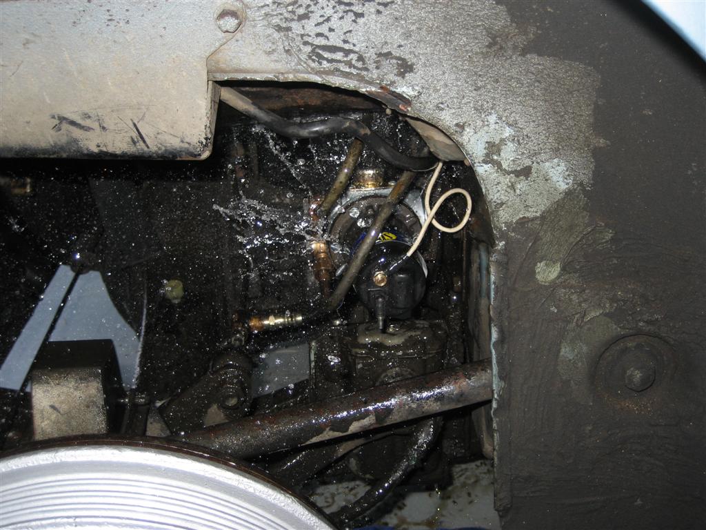

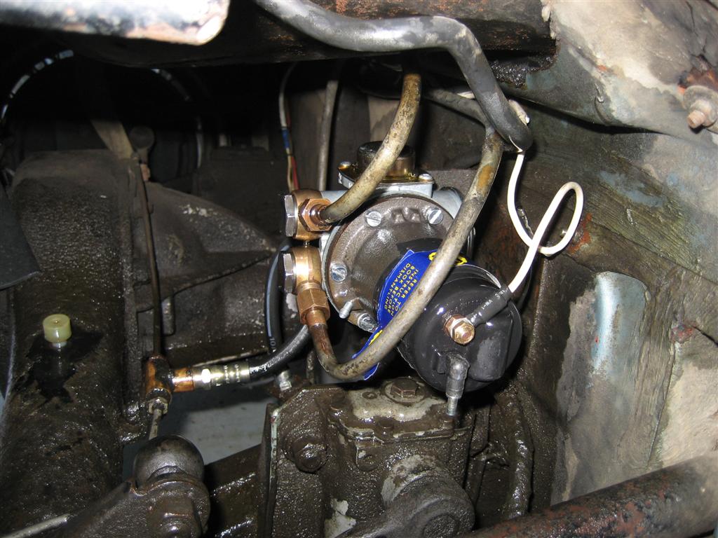

BrandonBJ8
Re: Installed new fuel pump - constant loud tickin
I took a picture of it while its on and off. Looking at it on it almost looks like I tightened it too tight and it loosened up the body. Any ideas?

Keoke
Re: Installed new fuel pump - constant loud ticking??
BrandonBJ8 said:
Keoke, should there be a washer on both sides of the banjo? Currently, they are just on the line side and not the pump side.
/bcforum/images/%%GRAEMLIN_URL%%/savewave.gif- /bcforum/images/%%GRAEMLIN_URL%%/yesnod.gif
Yes to properly seal the banjo washers should be used on both sides. /bcforum/images/%%GRAEMLIN_URL%%/nonono.gif Do not overtighten the banjos or you will strip the pump's threads.----Keoke- /bcforum/images/%%GRAEMLIN_URL%%/hammer.gif
If you look closely you will see that the lines are binding on the pumps housing because the pump's bosses are shorter. By tightening it you caused the tilt to be more sever. Leave the "O" rings in if they are ther and also add the paper washers.

BrandonBJ8
I figured it out. There was a screw on the pump housing that was loose. That combined with the pressure from the line pressing against the pump caused it to be an even larger gap. I pushed the fuel line away from the pump and tightened all screws. It's running well now with no leaks! I'll have to go pick up some paper washers though just in case. Thanks for the advice!
