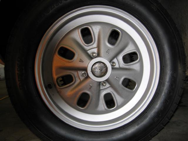

Dave--
I'm looking for one or more of the Elva cast magnesium wheels to match the four that I have on the car.
See photo attached for details--dunno if the letters are legible but it says E-L-V-A on the spokes.

Yep.....Those are the ones.
You say they are 4 1/2" (not 5") X 15" with a 4x4" bolt circle.
What is the backspacing.....I'm guessing 4 1/2"

Dave--
I'll have to wait to confirm the offset/backspacing--car is in NY and I am in MD. This, plus the wheel thickness, is what Dunbar wants to know. Meanwhile if you have a line on that fellow selling the wheels I would appreciate knowing.
