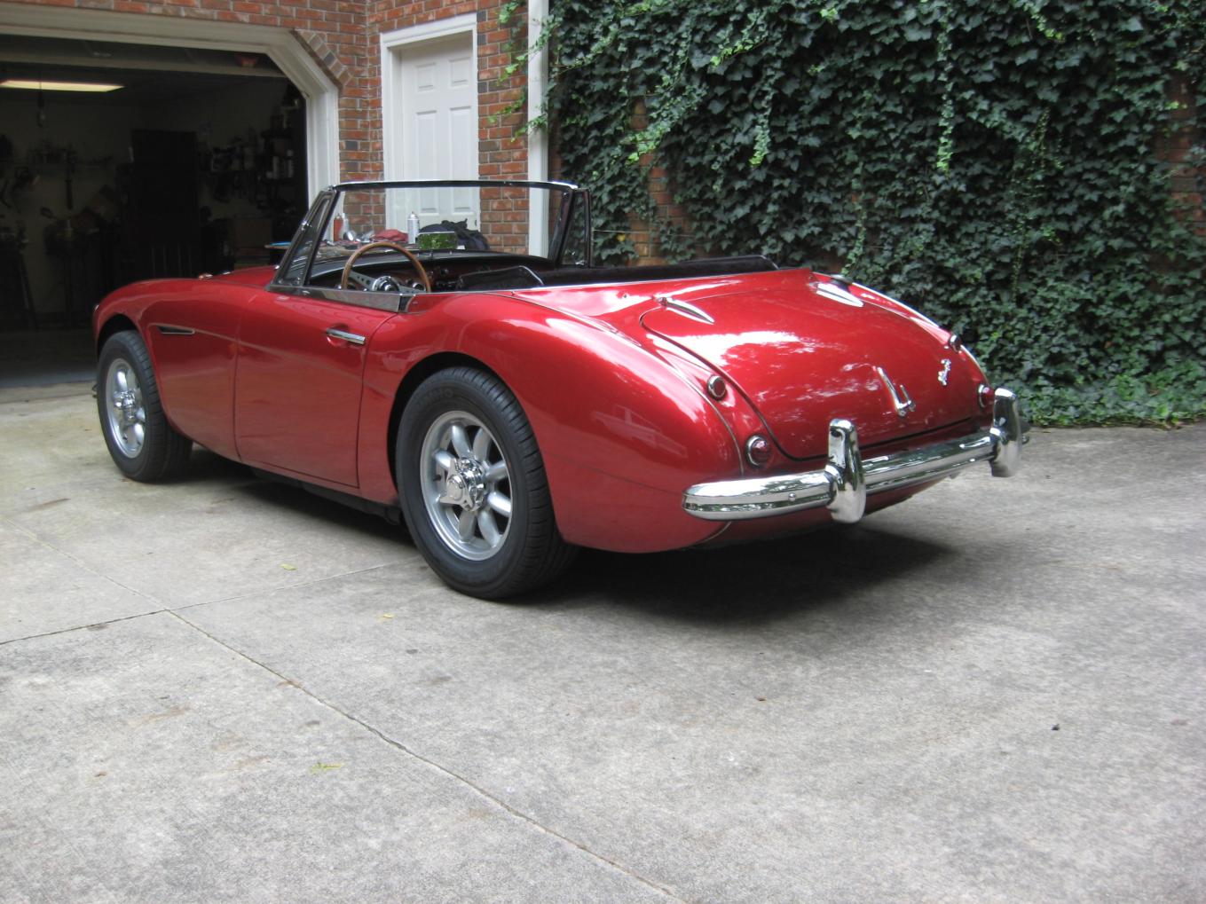

if i were to do that i would find a very nice conversion with mostly stock parts and start from there. i bought a very nice bj7 with a chevy motor and powerglide transmission.. i did not intend to revert back to original but i did want it to appear as original as possible. spend lots of dollars doing that....then i bought a 100-6 two seater in very good condition...and, i prefer to drive the nasty...stock healeys are just to slow for me and it has been my experience that a proper conversion drives and handles much better than an original with the heavy and overheating front end....the sixes they sound really good but the roar of a properly tuned v8 aint bad either. there is a rough conversion on ebay right now! good luck

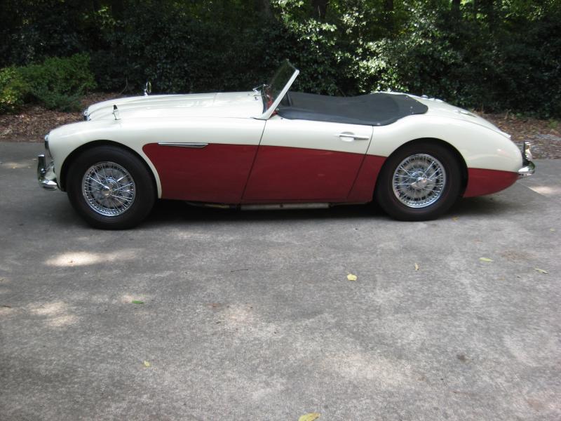

I saw that on ebay. With all the dents in the body, I wonder how bad that rust on the frame is. All the fenders had dents, almost looks like your race car. (just joking)

A few observations about this one that illustrate my points above. Engine mount towers are still intact, good. Motor has been installed without a lot of cutting (in fact, clearance looks really tight, spark plug changes must have been tough. Trans tunnel original?(did they get the shift lever through the original sideshift hole, I'm not familiar with the BN6 tunnel?) MGB rear end is a strange choice, less robust than the Healey, but probably installed with original mounting points. One more thing I forgot to mention if the car ran dual exhausts as most did, the right side outrigger will be clearanced for the pipe, check to see if it was bodged. Floors look good and doesn't appear to be a lot of body rust. OTOH, side arrows are backwards, so probably a deal breaker.

I like that one as it is. It would be way too much work to redo the fenders and other changes. Besides, it might be fun to drive!
