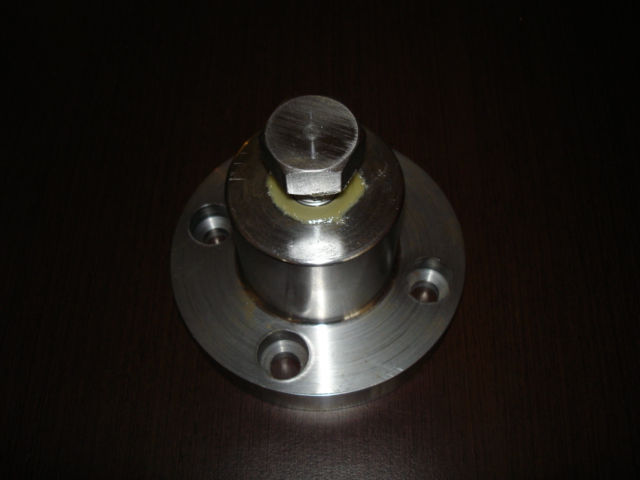

Look what just arrived. Anyone name this tool?

Yes; I probably should have posted in the tools forum. Figured it would be more fun here.
Yes, it is a puller. But for what and made by whom?
edit: this is quite possibly the highest quality tool I've ever bought.

the two bolts are for a handle to keep it stationary while tightening centre bolt. I had milled in two flats for a large 3in wrench but when I lent it out nobody had a wrench that big.
I started out with a 6x6in lump of 4140 steel and
machined into what you see here.

By the way I have a simpler device, simply a thick ring (3\4"0 of steel drilled to match the hub studs which I couple a stout two leg puller to. Works well.

Make a couple more of them will you? The hub pullers for the TR series are hard to find. Yours looks great.

Thanks Randy. I think this one is the tenth ? one I built. This is the only one I made out of a solid lump.The others were a three piece affair.One inch ring on the bottem drilled for hub fitment,welded to a heavy wall tube (half in/wall thickness) for the riser,then a two inch thick ring for the top machined to fit inside the tube and welded and drilled for centre bolt.
The one pictured is about 15 years old now, and done it's share of hubs.
No longer have a shop or lathe,since moving into the city .

I'm living+working in Europe (Crakow) for 6 months on a project. I had it shipped to my office in the UK and a colleague brought it over in his hand luggage. Got a few questions at Heathrow, but it made it just fine.
