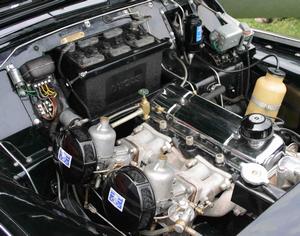

My wife also has a sharp nose for gas/oil smells from my TR3A. The last time, I knew something was leaking because I could smell it too. The fuel gauge went down to below zero as we drove the last 60 miles home. That's about 10 miles per gallon. I just made it home and there was nothing dripping. The cap for the float bowl on carb #2 was loose and the gas had been spilling out all over the inner fender. Luckily, none hit the exhaust manifold.
Don Elliott, Original Owner, 1958 TR3A

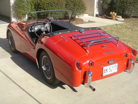

Thought I would bring this one to a close (I hope). After much exploration, it turns out the leak was coming from around the fuel level sending unit. I found this out at the gas pump. I was "lucky" enough to see gas on the ground immediately after I had pumped. I was very careful not to overfill, so I knew there was a leak. I quickly got behind the back seat to find that gas had come out the top around the sending unit. There was also evidence that gas had been spilling out of there already (the paint was eaten away on the tank). The gas was then of course getting on the carpet padding in the back seat. I knew it was a gamble since gaskets can be sensitive to over tightening, but I thought, "what the heck", and snugged the screws holding the sending unit. It turns out it was pretty loose.
After tightening and cleaning up the gas in the back area (it wasn't alot, but a little gas goes a long way from an oder standpoint), I drove around with the back seat out and monitored it to see if any gas spilled out. There was no evidence of a leak. So, I a hoping this is the end of this issue adn I can move on to the next one.
My guess is that the gas was sloshing around and leaking out the top and getting on the interior. And, even though I was careful on the fill, as it approached full the sloshing must have been enough to spill out. I thought I would be able to smell it directly, but since the carpet has that "rubber" backing on it, the gas did not soak into the carpet. It only soaked into the pad. So the smell was a little concealed.
Of course, my wife still thinks it stinks. I told, "tough poopy", which is probably what I should have said in the first place! /ubbthreads/images/graemlins/smile.gif
Thanks to everyone for there suggestions and for letting me know I am not the only one out there with a wife with the sence of smell of a dog.
