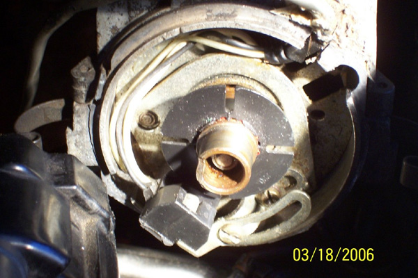

Ok, here's the pic Naomi sent me (I didn't get the second one - please send it seperately)...
Obviously a lightwheel setup going on here... (did Opus come with those? - I've never seen one)

Ok, I've never seen one, But, my bentley manual shows a magnetic ring and sensor on the original Opus one, but not a light sensor setup. I'd say that whatever old aftermarket electronic ignition is on your car probably needs replaced. I'd get a Pertronix setup myself... As I'm not sure you can get points for that Dizzy. By the dual wiring slots in the side of it, it does look like it might be the original 45De4 dizzy housing. That'll help in ordering a new electronic Pertronix or Fireball setup for it.
I've had a factory light wheel setup fail a couple times on my Eagle Talon. If you can ID what aftermarket electronic ignition is on the car, you might be able to get replacement bits for it... If not, I'd go with a whole new one. They only cost about $120-160 depending on where you get one.

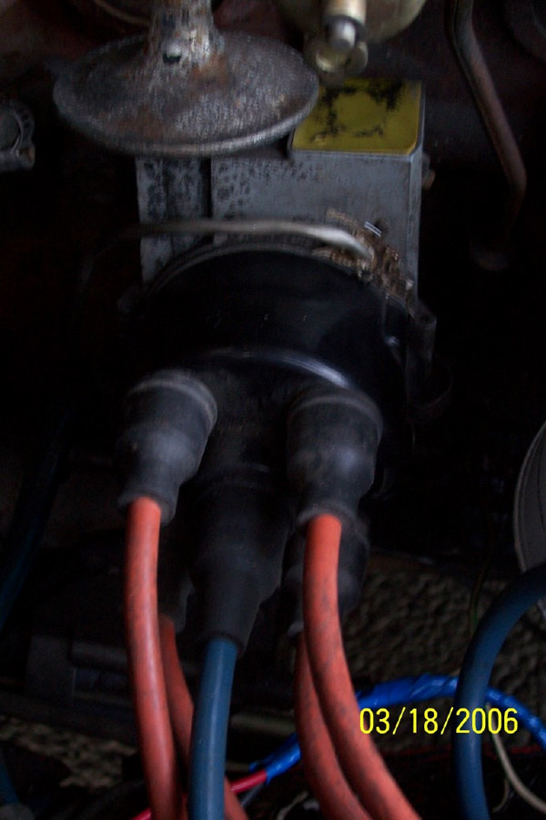

Here's the second pic (dizzy with the cap on)... Looks like a 45De4 Opus one to me... I'm just going on Bentley manual drawings though.

My choice would be to buy a used 25D4 distributor from Tony, and a new set of points... But I think you can get the pertronix setup for the dizzy you've got - Order it from Tony too... I don't think that it will be available at any local parts store - unfortunately.
