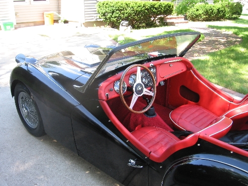

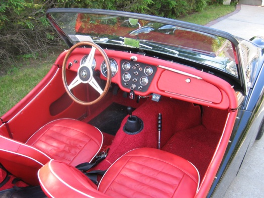

I don't have a Moto Lita wheel, but another aftermarket (Tourist Trophy) that I got from Moss. I'm not using the original control head, but I'm not home to measure the distance, but I don't think it's that far away. I'll post a couple of pics where you can see. I also looked on the Moss site at both the Moto Lita and the Tourist Trophy wheels, and BOTH OF THEM USE THE SAME ADAPTERS. If you want, when I get home, I'll measure, but after I mounted the new wheel, I didn't notice any difference in the location of the wheel. Also, do you happen to have an adjustable wheel??? As they always start further out then the non-adjustable wheel, and maybe the adapter for that is bringing it out even further.

Thanks for your help Art. I have made some enquiries from two other Mota Lita suppliers and they say that a Boss, I think simular to yours, with the TR Badge is about 1 1/2" shorter so I guess that will do the trick.
Sometime we learn the hard way after paying nearly $200 inc postage for the Boss that I already have.
