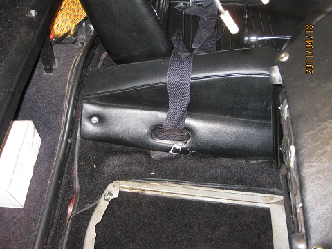

#66
On my 68 GT6:
Front and Rear: 3 1/2 inches wide (slight curve to profile so not exact)
Length: 26 inches
6 inches from the rear is a 1" x 3 1/2" oval shaped hole through which the seat belt feeds through.
The cover starts at the front of # 65 and ends at the rear of # 63.
Sorry for the imperial measurements, but it was the handy tapemeasure.
Can post some pics if needed.

A number of pictures will follow - tough at one per post.
Towards the bonnet

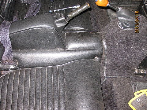

ArcticOne
Towards the boot
Can't get it all in one shot as the seat is in the way. Will take it out for some better pics.

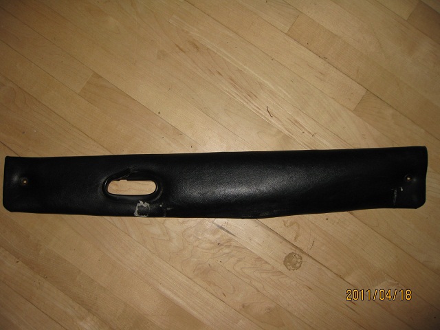

ArcticOne
More detailed measurements:
Overall length: 26"
Front width: 4 1/4" ish
Middle width: 4 1/2"
Rear width: 3 1/2"
Measurements are not the best as it is not a flat piece, but more formed / shaped to hug the tunnel cover.
It is a very heavy plastic / rubber piece (almost 1/4" thick). Mine has a leather / leatherette covering.
I would not use mine as a template as I think it was hand fashioned. Likely best to measure up your particular car and also figure out how high up the e-brake console you want it to ride.
If you need anything else please let me know.
jb
