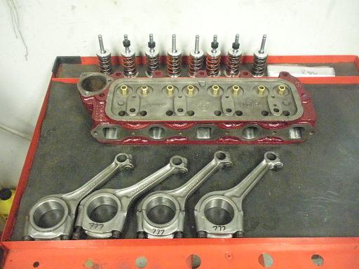

I sure would like to see more technical engine post here, heck more technical post about anything for that matter, so maybe I help can kick it off, a pretty picture always spike conversation. here's a MGB 1800 3 main head and set of rods I recently did for a fela in Texas, correct early MGB 3 main head fully ported and polished, with later style MGB valves, retainer,and collets, spo that way we could use the bigger 1.625" intake valves, HD valve springs, bronze guides, umbrella valve seals, instaed of those silly o-rings, and then a set of early 3 main connecting rods, I rebuilt, resized, balanced and ARP bolts installed, which is a bit creative job on 3 main engine's connecting rods. Enjoy,and hopefully topics like this can help for more technical post in this forum.

BEAUTY!!!! Where do you source your bronze guides, Hap? Or do you machine 'em there?

The bronze guides are available from all your normal sources, Moss, BPNW, now on a ported head like this, any head porter worth his salt is going to rework the guides, they are shortened, and reshaped, the exhaust are just bulleted on the end, I try to shape the entire section of the guides which extends into the port, on the intake, it is a bit more complicated method, I have lathe cutting tool I have custom shaped, so I can reduce the diameter in the port, and then radius back to it original diameter as it goes back into the casting of the head.

Basil, yes I do my own port and polishing and own my own flow bench.
Scott the uprated umbrella seals are listed in Moss' cylinder head section for MGB, Gordon at the B Hive also keeps them in stock, they are the best ones I have found form the MGB, because they work with all dual spring set ups, and are easy to install, just slip them over the top of the guide, much like the ones used on Spridget A series engines.
