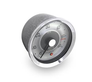

Has anyone changed the mechanical tachometer to electric? Modified the old housing? I have a 60 BN7. Here is a picture of what it looks like.

Are you trying to convert to electric and retain the white face gauge? You can't just substitute the white face onto a BJ8 tach as the gauge sweeps are different. There may be a way to change the electronics on the BJ8 tach to match the readings on the white gauge face, but I don't have the slightest clue how to do it. The other alternative would be to have a new gauge face made in white that would match the readings on the BJ8 tach. I wanted to keep the original tach when swapping in my V8 so I replaced the guts of the tach with SW innards and kept the original face. How I did it is here: https://forum.britishv8.org/read.php?13,8264 You could do something similar by using a tach calibrated to work with a six cylinder and having a 270 degree sweep that goes from 0-6000 rpm

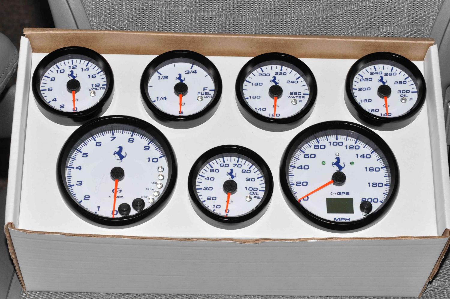

I have some custom Speedhut gauges they made for a 308 Ferrari I'm rebuilding. Good people to deal with. Here is the set I had made.
John
John
Nice cavallino rampante! Don't know if it matters to you, but if you try the Stewart Warner gauge transplant, the gauge does not park at "0" when the current to the gauge is cut off. It will keep a reading between 2-3k on the needle. Once you power the gauge, it will zero and provide proper RPMs when the engine starts.

Thanks Rick. You might not have noticed, but the numbers and emblem are dark blue which is the same color as the car. I sent them a jpeg of the horse and told them what color I wanted. Very accommodating people. Still working on that rebuild too. I hope to take the time to catalog the resto-mod since I'm doing a lot of mods.
