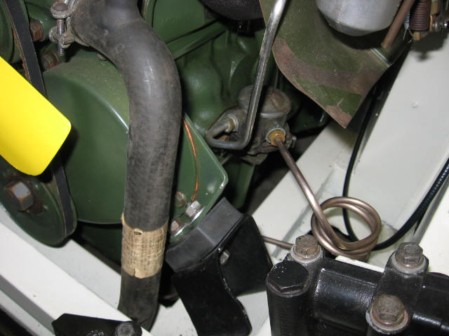

I'm getting close to having a driveable car.
I installed a new reproduction mechanical pump from VB this weekend replacing the original AC pump shown in the attached photo.
On the bench the new pump worked fine, but it didn't work on the car.
Comparing the lever/arm on the reproduction pump with the original AC pump, it did seem to be slightly different. Anyone else experience a problem like this with a reproduction fuel pump?
