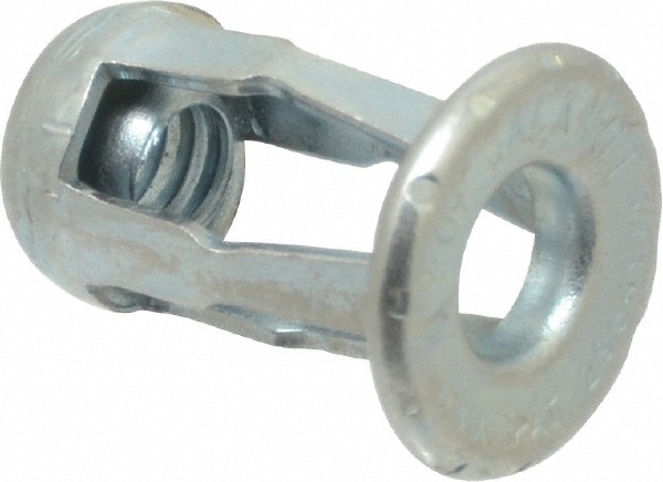

I have yet to install my luggage rack but when I do, I plan on using jack-nuts (like a rivnut) but with some silicone to seal them. The ones I bought are #13014 for 10-24 screws.
These jack nuts collapse and grip the inside of the trunk lid and are threaded. I'm not a fan of sheet metal screws.
