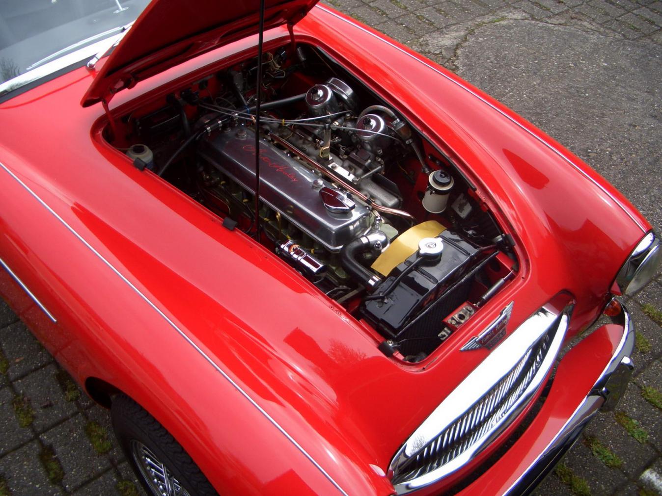

I am a Healey driver from germany
My car, a 3L MKIII, has crashed 4 batteries in 2 years .... today i got the fifth.....
The red ignition lamp goes off after starting and the current at the battery is ca. 12.5V.
The white/black wire from battery-switch to ignitioncoil is not connected. The car doesnt run with connectec wire. Last year i rebuild the ignition from IGNITOR back to contactbreaker and condenser.
Now my question: what is exactly the job off the w/b wire to the ignition coil? and could it be that is the reason for my problem?
thanks for ideas, suggestions
Happy Healeying
PS: excuse my small english
