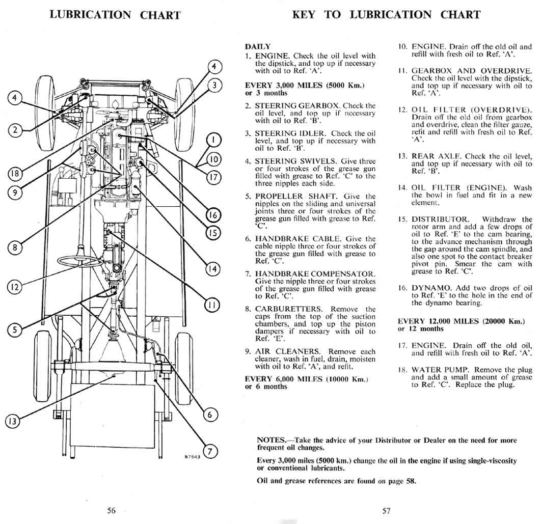

Is there a lubrication chart that shows ALL the spots to hit on a BJ8. I've been faking it but just found one I've never seen before (or don't remember seeing but then I don't rember seeing a chart either).

Hi TH,
I don't know if you have an owners manual. This chart was in mine.

I regularly hit all of the lube points except the rear one on the propeller shaft (#5), at least I think it's that one - it's the one that is tucked up in the frame members when looking up from below. Any tips on how to get a grease gun fitting on that one?

I have a short rubber extension that works fine on the rear of the driveshaft, it gets the front ones too, through the tunnel opening.
(I had the car on jack stands to get to the fitting though.)

Hi Wanna, yes get an extended fitting. British car specialties carries them. Better yet next change out use a sealed unit no greasing---Keoke
